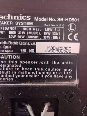

These are the images of the back of my technic speaker with the 4 cables. Can there be wired to the amp with only 2 ports?
Hi, I just looked into manual for Technics minisystem, which was sold with your speakers. This system has specific biamplification concept, with separate amp for bass (higher power) and for treeble (lower power). Here four wires have specific reason and purpose. It will the best to pair these speakers with original Technics minisystem. If you want to use your Denom PMS 300 amp with different speakers, than old Mission 701 are very good. I can recommend also old B&W 302 bookshelf speakers. They were very good in their time period (30 years ago). Or old KEF Coda are also very good and not expensive. BR.
Reactions: nopiano
I suspect not, as Andy said above. They were a system design, not meant to be used with other gear at all. I think the crossover is missing (because that was done in the amplifier/main unit), so pairing up LF and HF wouldn’t work with a full bandwidth signal from a normal amplifier. You’ll see that Caution appended too!
In any case they might well be clapped out, so I’d look further afield as you’re doing.
I suspect not, as Andy said above. They were a system design, not meant to be used with other gear at all. I think the crossover is missing (because that 2as done in the amplifier/main unit, so pairing up LF and HF wouldn’t work with a full bandwidth signal from a normal amplifier. You’ll see that Caution appended too!
This is "biamp system" used by Technics and Panasonic minisystems of its time. Also my big boombox Panasonic RX CT980 (What a great machine...) has used biamp system with separate amp for bass and treble sections. Using 4 wires as must. Technics has had quite good electronics that time, their speakers were more average sounding. BR.
