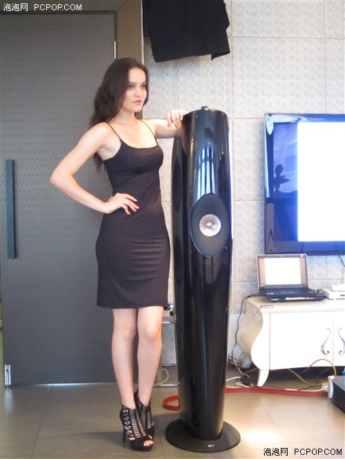

Dude...
Checkout the measurements from the R500s and R700s. They are immensely better than the standmount. Those darn laws of physics mess with audiophile small form factor fetish as usual.
Just look at these photos. Why would you want the LS50 over this?

Dude...
Are they under £1,000?
Yes more expensive floorstanders can be better depending on your room. Why would I want the LS50s probably because they are about £700. How much are those speakers?
