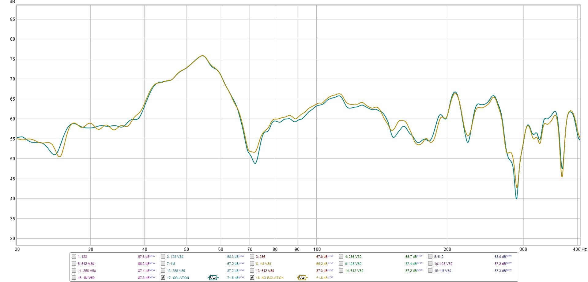

I've been experimenting recently with isolation products. Namely isolation platforms from Pyle (akin to Auralex).
My listening room has a suspended floor with lounge underneath it. Speakers are 42kg each.
Now for the best part. I'm mostly interested in acoustically measured differences. This way I can objectively state whether there's been any change. This is the only way I can tell if these products actually do something.
I've measured speakers individually. Left channel is closer to the middle of the room. Right closer to side wall. Left channel was supposed to be the only channel I measured as expected the results to be replicated in another channel.
Measurements were taken with REW at two volume levels and each length of sweep. Without isolation, with, with isolation and mic position raised, with mic position raised and timbre boards to mitigate speaker being raised. All resulting in approximately 40-or so individual sweeps.
The results were most interesting.
Left speaker was the first one to be measured and it was done more robustly. I only expected to measure one. The differences between putting timbre boards underneath and mitigating height difference are not worth a mention. So focusing only on straight No isolation vs Isolation comparison. Note that there's no smoothing, dsp and taken at usual listening postion. Also the new speaker position measures extremely poorly without DSP particuarly on the left speaker. Here goes BLUE - NO ISOLATION / YELLOW - ISOLATION
Right channel wasn't measured as robustly but I decided to see if the differences seen during first set of measurements would translate to the other speaker. Methodology was similar. This time with a little smoothing applied (1/48) as masurements were taken only at low volume. BLUE - ISOLATION / YELLOW - NO ISOLATION So happens it's the other way round to Left channel
Will you be discussing what you are hearing....and if it correlates with what you measured?
As you can see the left channel (no smoothing) improved the dip at 131Hz by just over 10dB as well as well as others upto 300Hz.
However usign the same platform on the right speakers exacerbated bass issues making the dips 3dB worse... 🙁
Genuinely baffled by my finding and shifting 42kg each speaker isn't easy. Particularly when I know it makes one channel measurably worse.

I have analysed the available data. I'm only bothered with cabinet vibration if it can be measured at listening position (hence heard). I'm not measuring earth quakes so don't care about seismographs 🙂
Yes, there are some differences to waterfall. Best to see them on Spectrogram (have a look on my Flickr https://flic.kr/s/aHsmeoF7PD ). But once again where one speaker measurably improves with this plartform the other one is worse.
It is most baffling and probably not the solution for me so will have to try something that works equally well on both.
