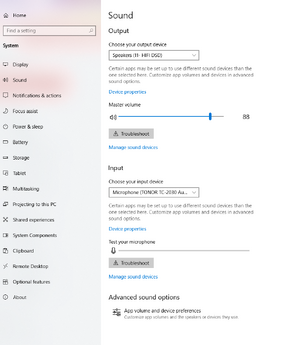

Then the dac came in the mail. Unplugged the mini rca, connected the amp & dac with the topping tcx1 xlr cables and a usb a/c directly into my motherboard. Updated both the amp and dac to the latest versions, got the right driver for the dac, swapped to the right output in the windows playback device section... no sound. Both the amp and dac turn on, screens work, windows recognizes the correct dac and even recognizes there's sound being played through the right playback device. Dac has been set to the right input aswell. I feel like I've tried most things, but I am very new to this.

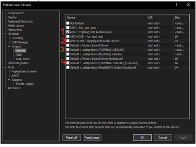

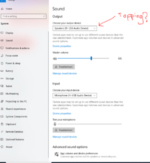

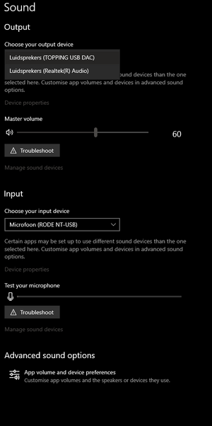

Have you done the basics in Windows setup? In the sound output option have you selected the Topping DACs?

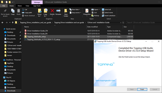

Sorry if this sounds obvious. I assume you downloaded the Topping USB (ASIO) drivers.
Haha, no worries at all. I've downloaded the Topping drivers, updated both the amp and dac to their latest firmware and have selected my output device to be 'Topping USB DAC' (this was 'Topping D70 Pro Sabre' before the driver install). Windows recognizes the DAC, there is volume being displayed on the screen of the DAC, I've selected USB on the DAC but the only thing that is missing is sound. I'll try reinstalling the drivers tonight to see if that makes any difference, but I just don't know how to troubleshoot this issue effectively.

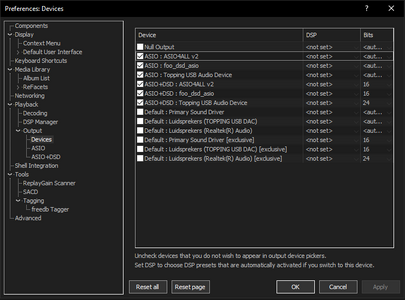

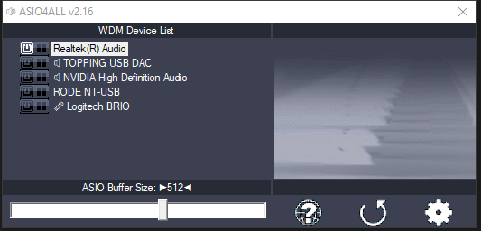

If the DAC isn't on, so just the AMP, audio plays fine through Realtek.

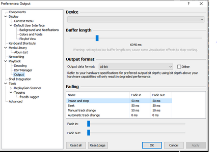

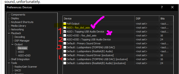

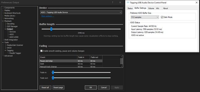

If you are using the Realtek sound device in your pc, whilst using your external DAC, you are sending the DAC an analogue signal, therefore it cannot do it’s job.

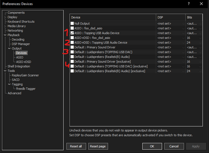

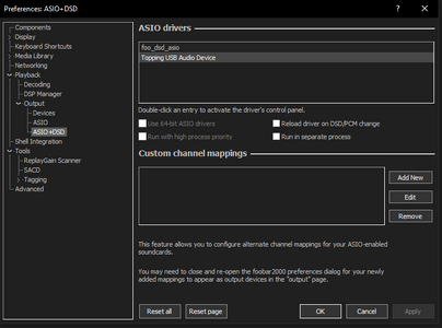

You need to use WASAPI or ASIO drivers to feed the DAC a digital signal via USB.
I use Foobar2000 and the ASIO drivers supplied by Pathos, to send to my headphone amp’s DAC via USB.
