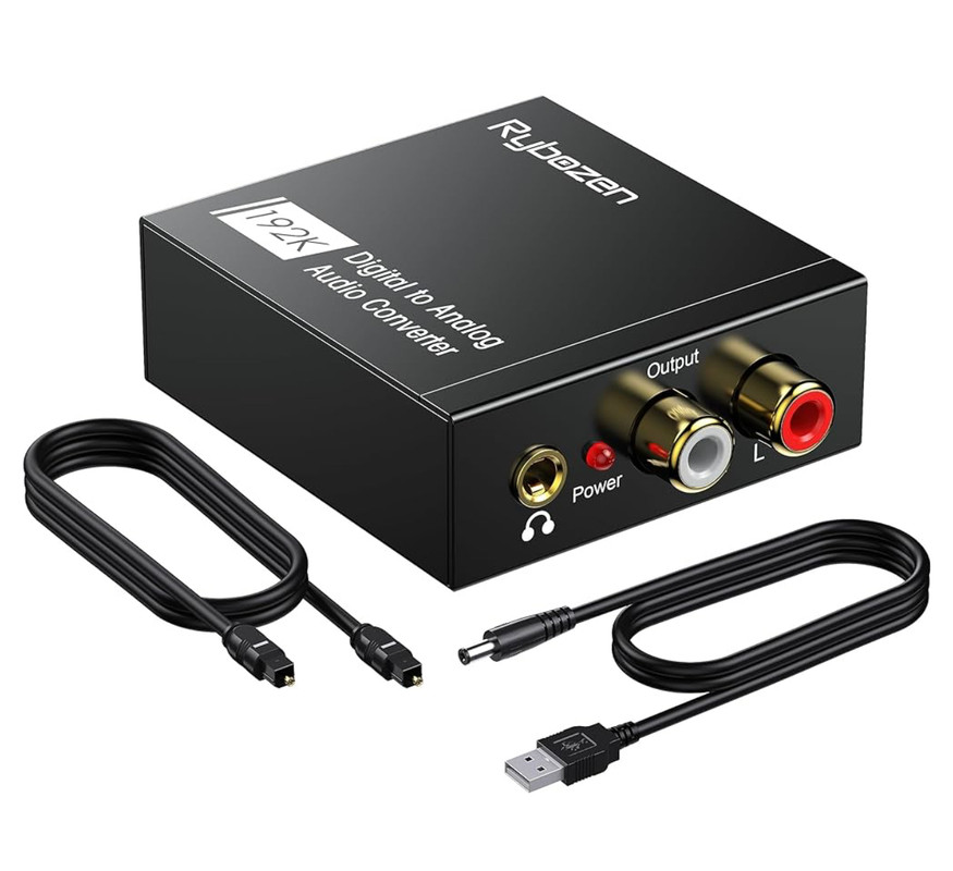

I imagine your TV will have a digital output, probably optical. Connect this to a cheap, basic DAC. An Fiio Taishan D03K for less than £20 should do the job if you can still get them. If not an Amazon Basics for a out £15. Then connect this directly to the amp via RCAs. Set the TV to external speakers.
As others have suggested, use the TV Optical out to a USB powered DAC, then use a RCA to RCA cable to your amplifier
Used to have this set up and it worked well.
