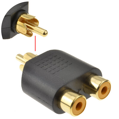

Split the output from the turntable's preamp - by using a couple of these:
