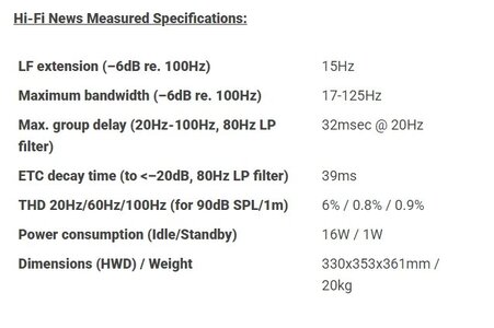

kef kc92 might sound good but look at the distortion number at 20hz at only 90db (rated at 11hz and 110db)
Surely a typo......
