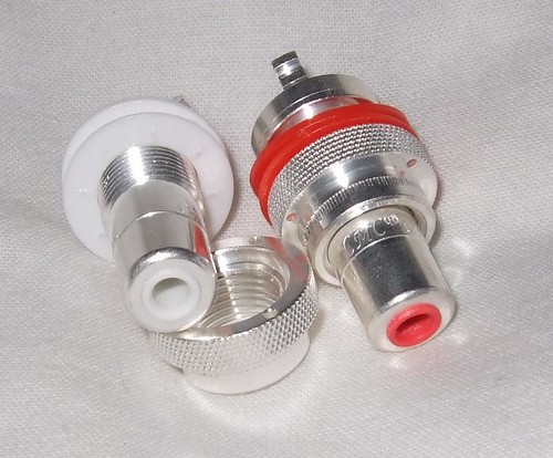

I've just gone completely bonkers and bought some rather expensive (for me) RCA sockets and binding posts.
CMC805-CU-AG: Pure Copper, Silver Plated RCA Sockets
CMC858-MU-AG: Pure Silver Plated Pure Copper Teflon Insulated Long Binding Posts (gold pictured)

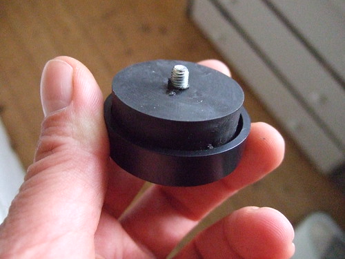

Two cases, feet for both and two 10mm thick front panels
Nice feet

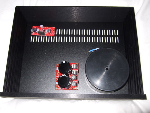

Lots of space for the fully encapsulated and potted toroidal transformer, PSU PCB and chip amp PCB.
Hopefully, there's enough space to allow an upgrade to a discrete amp circuit at a later date.
With the lid on.
OMG, these are lovely!
As are these. Fantastic quality.
