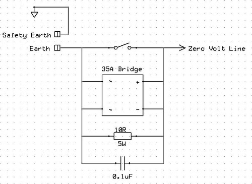

Momentary Pushbutton Switch Circuit with Sensing Loop

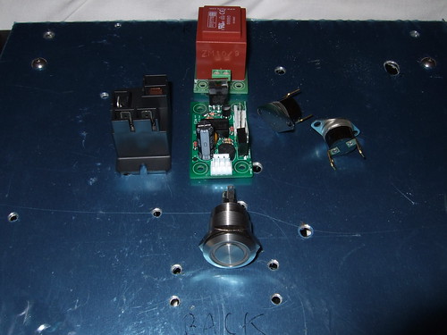

Initially, I didn't want a switch on the front of the power amps. However, given the soft start circuits, it seemed best to provide them. Indeed, the soft start circuit does support remote triggering, e.g. by a pre-amp, but let's not go there.
So, if I was to provide switches I wanted them to be nice like the Bulgin vandal-resistant series.
Buglin Anti-vandal Switch
As it happens AMB provides a PCB to support momentary pushbutton switchs. This is the Epsilion 24 (e24). This neat little board also provides dual LED support for the switch (to provide an indication of fault conditions) and supports thermal sensor arrays.
The e24 requires its own dedicated power supply. This can be provided by a miniature transformer and a PCB, the Sigma 24 (s24), is also provided by AMB.
I won't go into the workings of the e24, but essentially it allows the switch to be used to activate an off board relay. This relay breaks the live connection to the soft start circuit. The e24 also has an additional onboard relay which is triggered by devices on the sensor loop. When the sensors are triggered, they cause the onboard relay to act as though the switch had been pushed and switch off the power to the amp.
The sensors I have chosen are thermal devices. They are very much like switches and can be fixed onto heat sensitive components. They are ordinarily open (off). When a threshold temperaure is reached they close (on) and trigger the relay to turn off the amp. The plan is to attached the sensors onto the chips. I have selected variants which close at a temperature which is within the safe upper bound temperature of the chip.
Thermal Switch

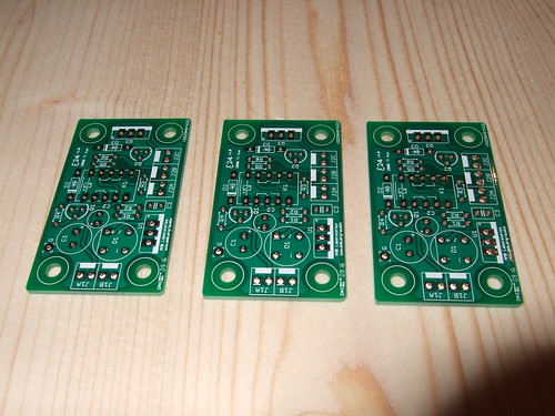

I have built the e24 and s24, so here are a few pictures.....
e24 PCBs

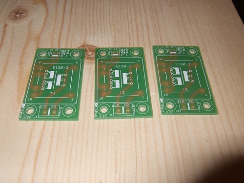

I've got three of these boards; one for each power amp and one for the pre-amp. Not sure which pre-amp I'll build yet. Something with valves might be nice.
e24 PCBs populated with components.
The e24s were easy to build and no issues were encountered along the way. That said, I haven't actually tested them yet.

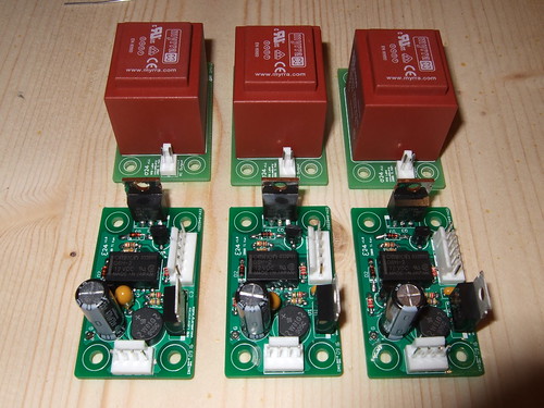

s24 PCBS.

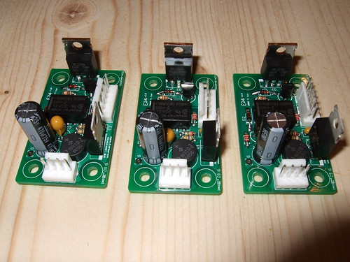

Here are the corresponding three s24 PCBs....one per e24.
e24 and s24 PCBs populated with components.
Again, no issues with construction to report.
The transformer provides 12VAC. The rectifier to convert AC to DC is held on the e24. After rectification, about 17VDC is provided. A regulator is used to drop this down to the required 12 VDC. A stable voltage, as provided by the regulator, is required to prevent false triggering of the circuitry because fluctuations in voltage can fool the circuit into thinking the pushbutton switch has been pressed.
Power switch components for one amp.
So, in the centre is the e24 with the s24 directly behind it. To the left of the e24 is the relay which switchs the main power supply to the soft start circuit. To the right are the thermal sensors. At the front is the push button switch.
The e24 is designed to sit on top of the s24, making for a much more compact component.

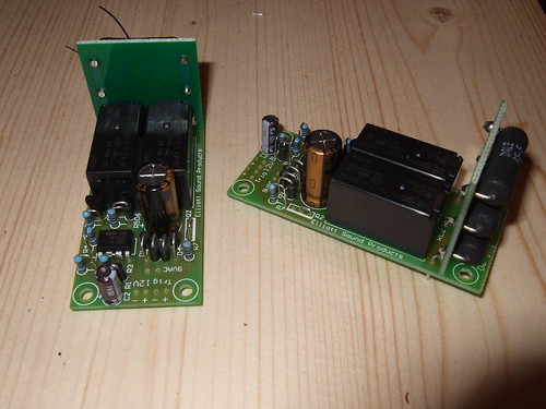

Here's a picture of the completed soft start modules. You can see the bank of resistors on the upright PCB. These resist the flow of current into the primary transformer while the timing capacitor is charging. It's the small one right on the front edge of the main PCB.
You can also see the relays (black boxes) on the main PCB. When the timing capacitor is charged, the relays are activated causing the bank of resistors to be short circuited thereby providing full current to the primary transformer.

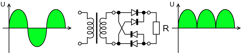

The AC is converted to DC by the bridge rectifier. This comprises of 4 diodes which are arranged to convert the negative part of the sine wave to positive (see below). The resulting DC is measured in a different way to the AC. It is the peak value which is quoted. So 25VAC provides 35.4 VDC (the AC peak value). This assumes a 100% efficient bridge rectifier. In practise, a little voltage is lost to the diodes.
You'll notice that the DC is decidedly wobbly rather than a constant value. This is termed ripple and is a reflection of the AC origins of the DC. Ripple is bad for audio. So, how to get rid of it? The most common approach is a place large smoothing capacitor just after the bridge rectifier. This discharges to fill the troughs between the peaks but its effectiveness reduces before the next peak is reached, resulting in a smaller ripple. The module I've built uses this approach.

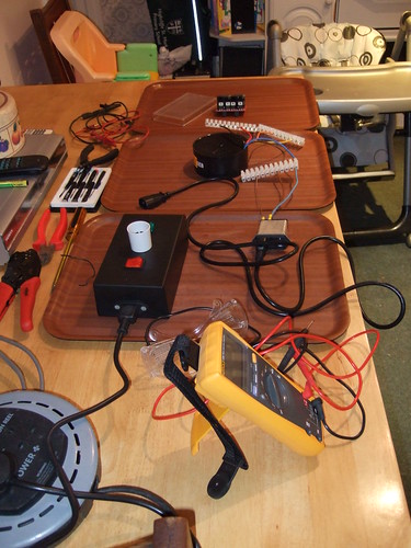

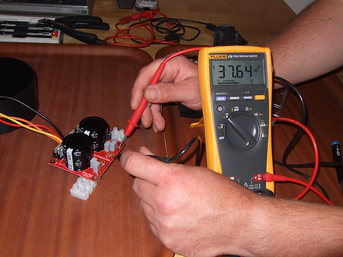

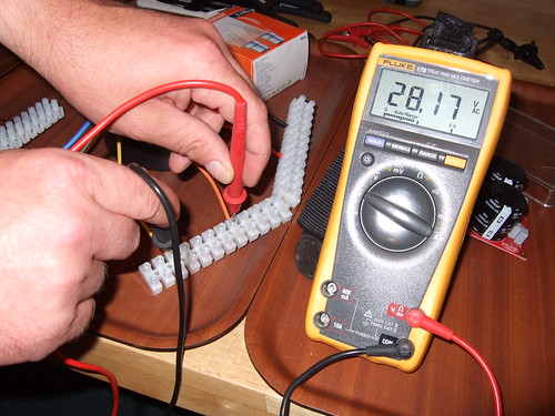

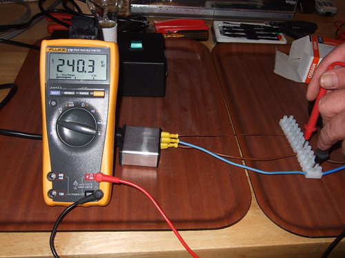

OK. The only recourse then, is practical experiment. I'll try and do something tonight. My transformer produces a RMS of 25 VAC. After rectfication (and smoothing), I expect this to produce 25 * sqrt(2) = 35.4 VDC or there abouts. There should be some loses due to the diodes in the bridge (0.7 VDC each?) so around 33 VDC.
So I'll state my null hypothesis....
25VAC will produce approx 33 VDC after rectification and smoothing.
The experiment will serve to reject or accept this hypothesis.
OK. The results are in........
In the first picture you can see my rig, which comprised of an IEC power inlet module, a 160 VA transformer and a power supply module with onboard bridge rectifier and smoothing capacitors.
Test Rig.
My first test was to ensure that the correct voltage was being provided by the power inlet module. The reading I was able to take was 240.3 VAC. Remember, this is the RMS value. It's a pity at this point that my Fluke doesn't allow the measurement of peak and peak to peak values....but there you go.
Mains VAC (RMS).
The next step was to measure the VAC (RMS) being produced by the transformer. I was slightly surprised that this was 28.2 VAC.
Secondary VAC (RMS) produced by transformer.
This is three volts more than I was expecting and will impact the H0. Therefore, I will need to restate the H0 to match the available voltage.
So, 28.2 * sqrt(2) = 39.9 VDC. Each diode will lose about 0.7 VDC and there are four of them, making 0.7 x 4 = 2.8 VDC. So the expected VDC is 39.9 - 2.8 = 37.1.
H0: 28.2 VAC will produce approx 37.1 VDC after rectification and smoothing
The final picture shows the measured VDC at the output of the power supply module. Is is a little higher than I would have expected at 37.64 VDC but in my opinion it is near enough to allow H0 to be accepted.
VDC after full rectification and smoothing.
I have exhausted all possible further avenues for proving my argument...except finding that documented statement from a government (or similar) site. I spent some time trying to find this today and had to give up (the kids were bored). However, I am satisfied that the theory, foray into first principals and now the supporting data present a pretty convincing argument.
However, I am still open to further debate and accept my experience is limited.
I will try to clear the confusions.

Disconnecting Network
Within audio equipment there are two grounds. These are signal and power ground. Audio designers usually like to keep these as separate as possible as noise from the power ground can pollute the signal ground. However, when these are connected directly to Safety Earth the result can be ground loops.
So what is a ground loop? Consider a CDP and an amp. Each are connected to earth in the wall via their mains plug. When you run electrical interconnects between the CDP and amp a local loop is created eg one can trace a connected path from the CDP through to the amp via the interconnect, through the signal ground in the amp to the Safety Earth, down the mains cable to the wall socket, along the earth wire to the CDP mains socket, up the mains cable to the CDP Safety Earth and into the signal ground.
What travels around this loop? Current created by, for instance, stray magnetic fields. These fields are generated by the transformers in the connected audio equipment. This circulating current gives rise to the characteristic hum in audio equipment and hum bars in video.
To overcome ground loops, a number of strategies can be adopted.
Firstly, something basic. You can disconnect the earth wire in the plug of either the CDP or amp. Alternatively, one can use a plug with a dummy (plastic) pin. People do actually do this and it does work. But what you are left with is a real risk of electrocution or fire.
Let's say a stray wire in the equipment with the removed earth comes detached and contacts the case. A sudden, massive spike in current will rush into the power/signal circuit and attempt to run to earth through the interconnects and into the equipment which is still connected to mains earth. These interconnects, which are not designed to handle the current involved, are highly likely to cause a fire. If you are unlucky, somewhere a component may fry breaking the path through the signal ground leaving you with a live case waiting to (possibly) kill you.
Another strategy is to "lift" the signal ground above the Safety Earth. To do this one connects all of the grounds in the equipment to a single point (star ground) and then place a resistor between ths point and the Safety Earth. This resistor serves to resist the circulating current travelling around the local loop and prevents the hum.
Again, however, should a fault occur on the PCB, the current will rush through the resistor which is likely to fail. We are then back in a similar situation as before. So, this approach is not generally recommended although you will see it being used in the DIY community.
The disconnecting network is similar to the resistor approach but uses more robust components which are ensured to survive the currents involved during a fault. Consider the picture below.
The Safety Earth attaches the earth wire from the mains cable to the case. The zero volt line connects the network to the star ground. During normal operation the resistor lifts the internal ground and prevents the loop. The cap helps reduce noise. The diode bridge provides two paths to earth in the event of a fault. So, if one path fails there is another as backup. Moreover, the bridge contains very solid conductors making failure unlikely. The switch allows the disconnecting network to be bypassed (if a ground loop is absent) but still provides a route for the fault current to Safety Earth via the bridge.
This latter option seemed to be a pretty good to me and if it's good enough for Bryston (I've seen Bryston schematics which include exactly the same components as the disconnecting network), it's good enough for me!
