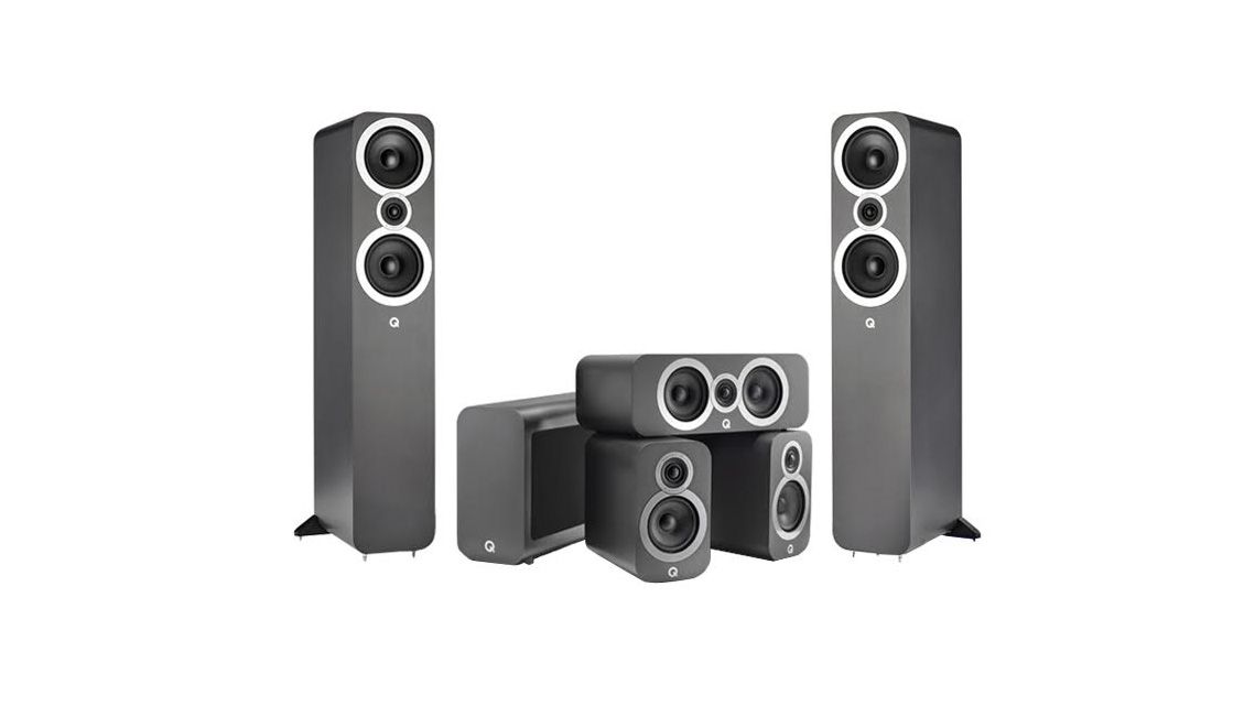

Bit of a generalisation, but Cyrus amps always sounded on the brighter, lighter side to me, with little natural warmth. So, if you stick with them, I’d suggest Q Acoustics speakers as a range to explore :-
a. They are on the smooth, warm side.
b. They are widely available and great value
c. They do home cinema bundles if that’s what you need.
All the individual pairs are great in their own right too.
