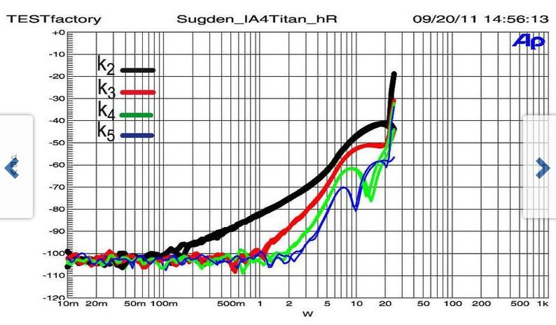

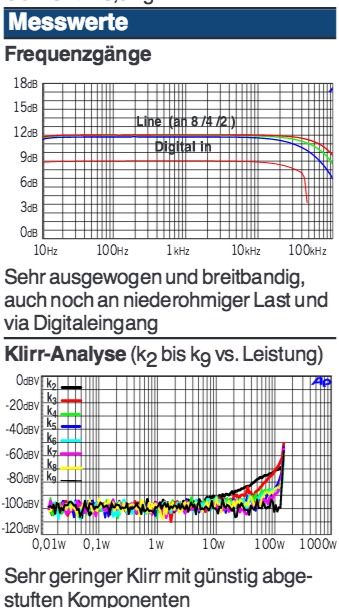

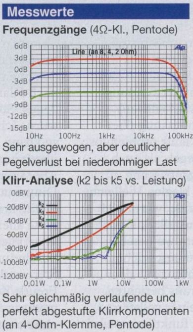

Mesure and distorsion of a Ayon Orion tube amplifier :
Mesure and distortion for a Unison Simply Italy tube amplifier :
Mesure and distortion of an Accuphase E-213 transitor amplifier (A/B) :
Distorsion of a Sugden Masterclass IA4 (A)
Credits : All mesures are property of Stereoplay, Tom Klasing Verlag. Use is only for eductional purpose.
And your point is?? Oh, it's measure by the way ;-)
