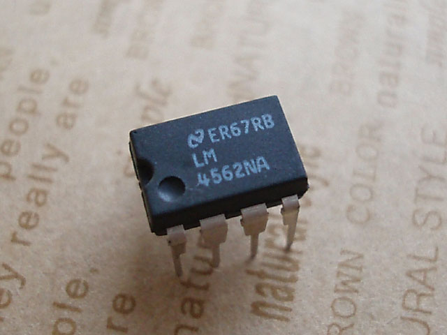

Chebby, I also just changed toÿLM4562NA op amps and the difference is totally striking! the best bargain piece of hifi upgrade just got even better. ÿThe detail is way more pronounced, bottom end more balanced and the top less harsh i think. ÿI'm 1 hour into listening so i guess they'll need to run in a little but how are you finding yours since changing over?....ÿ

If you own the 7520, SERIOUSLY consider getting the ÿLM4562NA's - £7 quid from ebay.... easy to fit and an unbelievable upgrade. I was considering some new speakers but really don't think i need to now. ÿ

Unplug the DAC from everything and remove 4 little screws holding the top cover on. Slide off top cover.
Ease out the two opamps carefully from their sockets. (Delicate use of a jeweller's flat blade screwdriver may help to ease them out but just exercise care and dont use other components for leverage!)
There are only two such components in 8 pin sockets - everything else is soldered - so you cant accidently replace the wrong things......
(Make a note of which way around the opamps are so you don't try and put the new ones in the wrong way around.)
Carefully push the new opamps firmly into place in the vacant sockets.
Screw cover back on.
Enjoy.
No soldering and no electronics knowledge required. Just a little care and a well lit table-top.
(Make sure you order LM4562NA and not any other LM4562 variant.)

Thanks for the explanation. Very clear now. Unfortunately, the shop that sells them asked me whether i wanted a MDIP or SOIC format? What is he talking about? Can you shed some light on this formats?

LM4562NA already denotes the item as a Dip-8 device.
It fits in an adaptor like this...
And will have legs like this.....
Frankly the guy should know from the catalogue if you give him the correct full nomenclature.
I used this trader and had no problems. Recommended to me by plenty of other people doing the same mod.
Don't get anything described as SOIC. It would be smaller and be the soldered version LM4562MA and the WRONG one.
I guess MA and NA sound the same on the phone so be careful he is clear you want the LM4562NA

Anyone confirm that these are the op amp being talked about.Does the 'nopb' bit mean that they might not be the same thing ?
Found them on Farnell w.site £4.03 each plus postage.
http://uk.farnell.com/national-semiconductor/lm4562na-nopb/opamp-audio-dual-hf-8-dip/dp/1685366
NATIONAL SEMICONDUCTOR - LM4562NA/NOPB - OPAMP AUDIO DUAL HF 8-DIP

DAC just arrived, not even turned it on and Im putting the new op-amps in. Can I just double check with someone else who has done this upgrade that the position of the writing on the old ops was upside down with the writing "24bit 96khz Digital..." like this:
http://img522.imageshack.us/my.php?image=opamps.jpg
And that the new ones should be upside down too, with the dark circle in the top right corner of the new ops?
