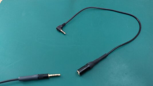

I use a home-made, cabled version to give standard unbalanced 3.5mm from a laptop to my Sennheiser balanced:
But solid adaptors are available 👍
It would have been a 2.5mm end that connected to the 598s' input and a balanced 2.5mm 90-degree end that connects to the 2.5mm balanced output on my HiBy DAP. I may be able to look up specs, but it was in early 2022. It's not a connector as in your photo; it's a full cable. (I've recently seen a 4.4mm cable available for a set of dual-input Fiio JadeAudio JT3s at amazondotcom, so they must be available for the dual-input HD600 cables.)
