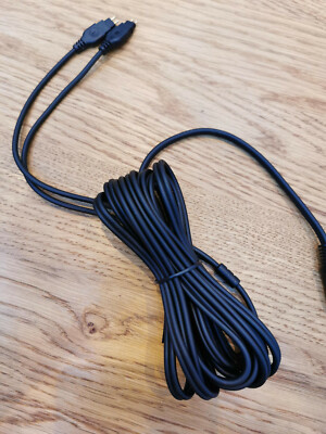

I got the balanced cable for my HD650's from a guy on eBay. It was a pukka Sennheiser cable converted to balanced. I'll see if I can find the seller and the price in my purchase history. My HD800S's came with an additional balanced cable.
Here you go:

I found these cable options on Amazon and also these and I'm going to order one of them. Can some kind person please confirm for my addled old brain that this is the right thing to order and also should I prefer one over the other?
