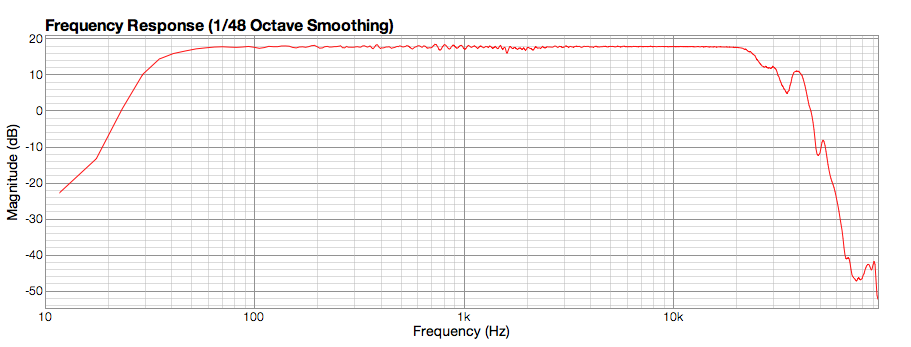

The frequency response chart shown on the Unity Audio website for their Rock Mark II is a totally misleading work of marketing art / fiction:
This website here explains the tricks they're up to:
http://www.audioholics.com/loudspeaker-design/audio-measurements
On that basis I would be very skeptical about the 100 watt amplification claims by Unity Audio. They don't state whether this figure is 8 ohms continuous or not.
