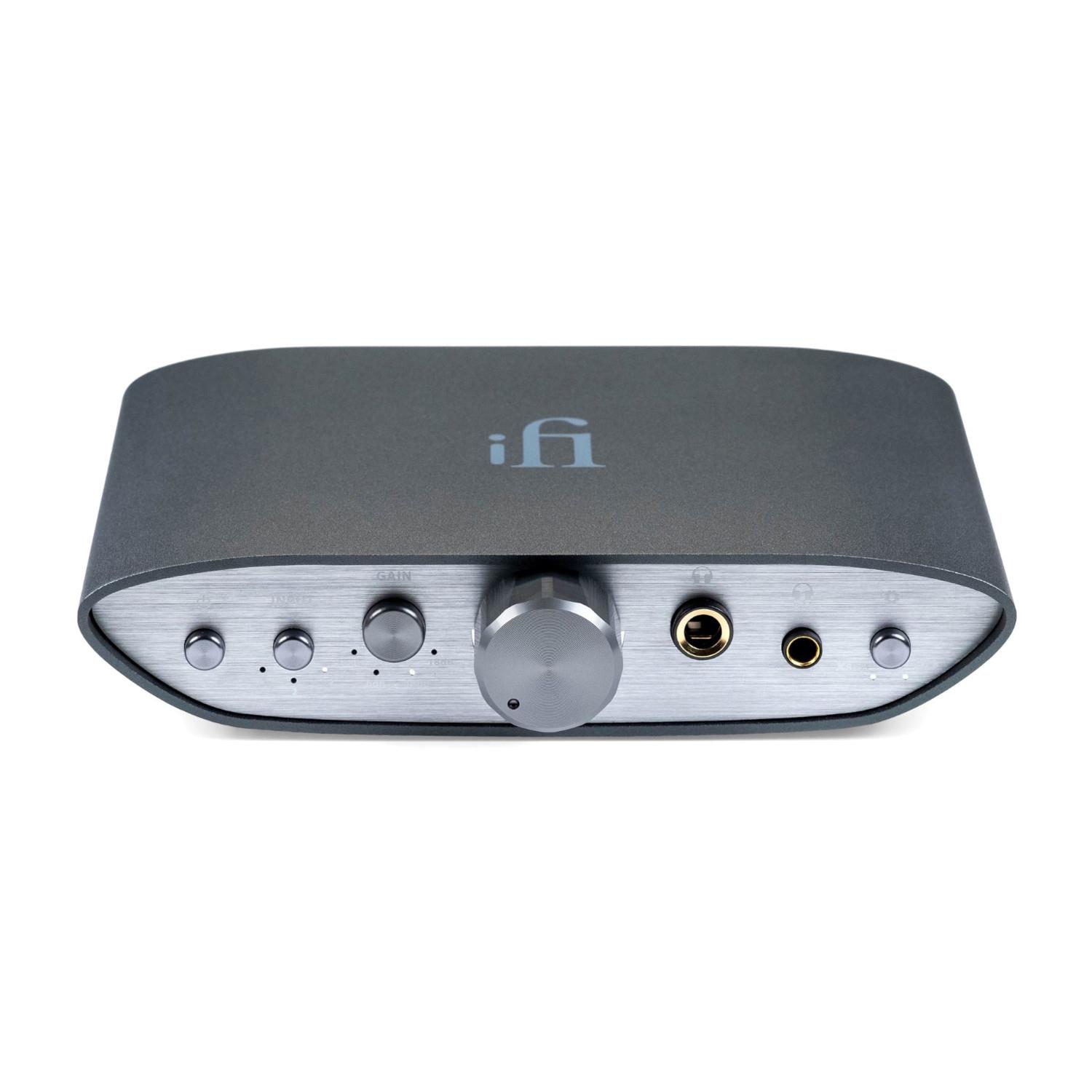

You really can't go wrong with any of the ~$100 range headphone amps. Schiit, iFi, Topping, SMSL, JDS Labs, etc. If you wanted to up that a little bit the class A Aune X7S has amazing synergy with Sennheiser headphones. Most likely that would be true with any class A amp. Senns love anything with a little warmth. Tube amps as well.
