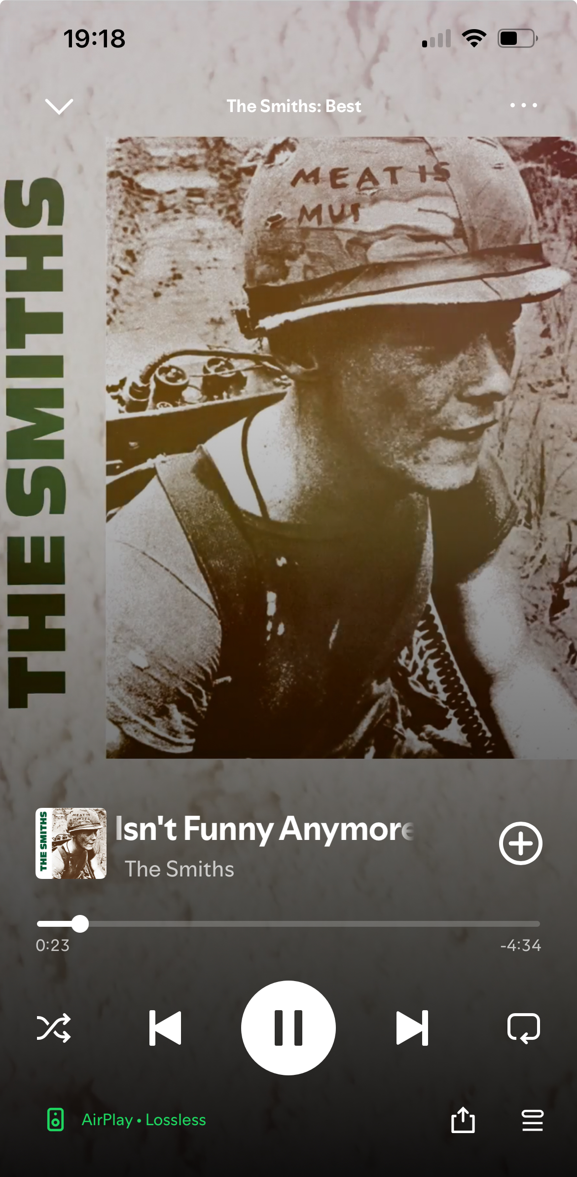

For reference here’s I what I see using AirPlay to either previously mentioned device. Is that just poor UX: two different messages next to each other?
I’m no expert so will defer to your expertise.
All that says is that you're using the Spotify Lossless option. Airplay does not do lossless however. Airplay is just being seen as a device by Spotify to stream to. Come on! Common sense should tell you that.
I’m lucky to have a brain than often skips common sense, so such issues never really bother me. Never used AirPlay much before so have no idea about its capabilities. As I said, happy to be corrected - I’d read it on another forum & tried it. As per the screenshot, the way Spotify presents the information isn’t exactly transparent in what’s happening.
Reactions: manicm
This setup will be absolutely spot on for Spotify Lossless via Spotify Connect. AirPlay has got nothing to do with it. Spotify Connect streams the audio directly from their server to the playback device, which would be the WiiM in this situation.
And Spotify presents the info just fine - it is telling you what stream is going through their side. Anything after that is out of their control.
