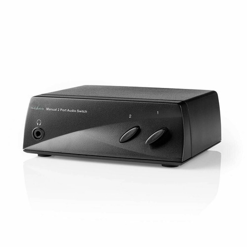

The Schiit Sys is OK for selecting which of your amps gets the Modi out on their input.
But you want to switch between 2 headphone outputs - in which case you need just a straight switcher like:
(Ignore the single 3 star review which mentions a PSU, the switcher doesn't use one).
With one of these (available in 4 different lengths) plugged into each of your headphone outputs:
No soldering required 👍

So... I would just have to switch the SYS and and the Nedis at the same time... I can totally live with that.

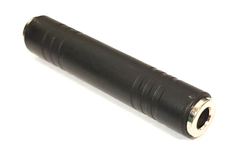

Up to you, but personally I don't like don't like 3.5mm sockets. If your headphones have the full-sized jack, you might prefer to use another 6.3mm to twin RCA lead connected to the rear output sockets and couple it to your headphone plug with:
That's an elegant solution... much appreciated!
