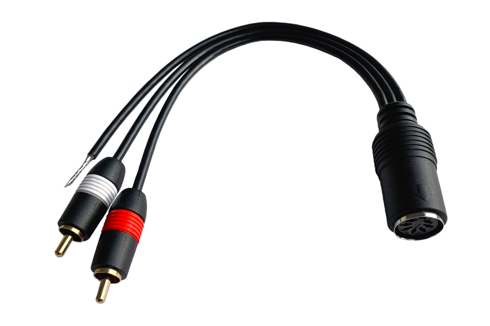

I’m having a bit of trouble finding the right cable for my setup. I need a female 5-pin DIN to 2 male RCA cable. I recently bought one that seemed to fit the bill, but unfortunately, it only outputs sound from one speaker.

This is the cable I bought last time:
If anyone has a recommendation for a cable that would work, I’d love to hear it. Also, if you have the same or a similar turntable, I’d be interested to know what cable you’re using with it.

But you need to know for sure how your turntable's DIN PLUG is wired, before you can buy the appropriate DIN socket to RCA phono cable.
The pinout of the plug will be shown somewhere, either in the user instruction manual, or online somewhere.
For absolute certainty, it's an easy job to slide back the plastic cover on the plug and have a look what pins the wires are connected to.
You'll see a small square on the body - its where you push in a sprung metal piece - that allows the cover to slide backwards from the plug / pins body.
If you don't know what you're looking at - just post a zoomed in picture of the wired pins and we'll advise.
Do the same with the socket you've bought and there's a good chance you'll see why it only works on one channel (the wiring will not be matching the plug wiring - which it needs to be).

If I understood you right you meant to open the din check that if the din is 1-5 pins and holes than making sure that pin 1 is red and also hole 1 is red and then 2 is white etc.
I found the TT manual online but couldn’t find anything about the adapter.
Also it’s very difficult to open the din of the TT, is it supposed to be like that?
I couldn’t open the adapter female din at all since it doesnt have this little square that supposed to be pushed inside.
And I couldn’t find anything online about it , what would you recommend ?

Cheap DIN plugs will be moulded plastic and pretty impossible to open. You need to find an adapter with a metal bodied plug.

Yes, with both plug and socket wiring exposed, you could clearly see whether the pins and pin receptacles correspond correctly.
It's the pinout of the turntable's DIN plug you wanted to see.
Well, they didn't think anyone would need to open it 🙂
You asked what I would suggest 🤔.....
Maybe contact the place where you bought the adaptor, they will know whether it should be working for you.
Failing that, if you can get it to me in Essex....in the (unlikely) event that I couldn't get into the DIN plug, I'd fit a twin RCA cable right the way from your turntable.
(And you could keep the DIN cable in case you ever wanted to revert the TT to original and sell it). 👍

Here is my latest update: i contacted the shop that sold that DIN to RCA adapter and they will send a new on on the house. nice of them, hope it will work.
i wanted to try to modify the R&L inside the din and i opened it but ev erything is soldered inside and at this point i just understand that since i can't solder it myself and it means that i have to go to a professional anyways if i got to modify it.
I was thinking of maybe changing this to a RCA and finish with all that DIN story.
what do you think ?

If that shop is sending you the same as what you have,then it's likely to give the same result.
...but it would be a very easy job for someone to find out what you need, then modify the adaptor (and possibly charge you less than you paid for the adaptor!).
The same person could easily convert you from DIN to RCA.
