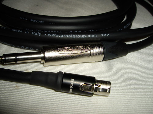

This is my new headphone cable for the K702s. It is a cheat, using a jack to XLR from ThatCable. I originally bought it and took it apart to see how they work. I needed to swap the XLR with a mini XLR.
First I had to remove the strain relief from the mini XLR to stand any chance of fitting it. A stanley knife and pliers did the trick. Then I prepared the wires. I don't know why, but the cable is packed with string as well as the three wires.
Then, using the DMM, I figured out which wire goes to the tip, ring and ground. Different wires have different colours and phonos and jacks can be different too. It is not as easy as wiring a plug. You can see from the final picture the size difference. I need to finish it with heat shrink, instead of the electrical tape that I had.
Sound wise I cannot hear any difference between it and the standard AKG cable. But I have more volume range to play with.

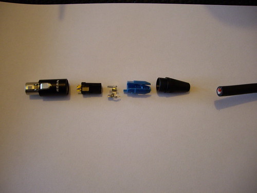

The Meteor II using Proel microphone cable and Neutrik Rean XLR and jack.......
I had to cut the strain relief off to fit the cable and put some heatshrink on to cover the join........
I changed the larger blue strain relief for a smaller black one. Putting that with the metal band and the head of the XLR together is very fiddly........

The jack is very well made and far simpler to put on.......
The top connection is the ring, the middle hole is the tip and the lower part the ground......
The finished article.................

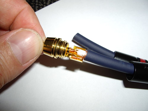

The Solar MkII with Van Damme cable.
I pealed apart the cable and removed the plastic inner bit. I decided to have a go with some heatshrink to keep the rest together.
This getting the cut lengths right before soldering. This is quite a thick cable with a stiff inner sheething over a more flexible outer sheeting. I hardly trim any cable back and only have tiny bits of wire to work with.
The wires are tinned and everything is in place to solder on the phonos
Phonos are on
The finished product, well maybe. Tbe heat shrink would not shrink with the hairdryer, which other heat shrink I have used did. So I used the soldering iron instead, but it curled up at the ends. So it may be cut off.
