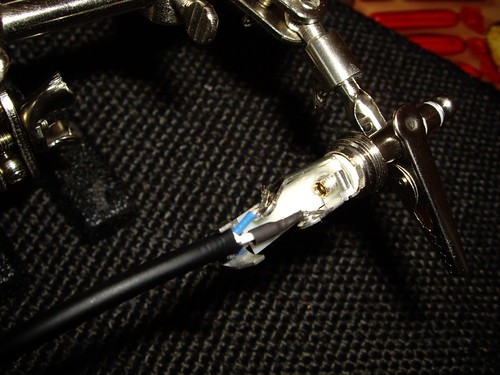

I have now made a headphone cable which is called the OOTW Meteor. First measure, cut the cable and ensure ground to ground, signal to signal and return to return.........
White is the signal, blue the return and the bare wire with some heat shrink is the ground.
Here 1 is ground and goes to the sleeve, 2 is signal and goes to the tip and is white and 3 is return and goes to the ring and is white
The jack soldered. I put some heat shrink over the white wire to protect it against the heat generated as you solder the rest of the phono. It gets very hot and the helping hand acts as a heat sink to take away some of the heat. You cannot see the ground as it is under a piece of plastic that acts as a barrier to protect it. That was fiddly getting the plastic out of the way to solder and then push it back into place. The soldering is by tinning the wires, tinning the contacts and then placing them against each other and applying the soldering iron from the otherside of the connection. The heat them melts the solder on the connection and the wire and with a puff of the rosin core which is an acid that keeps the join clear, they fuse together.
