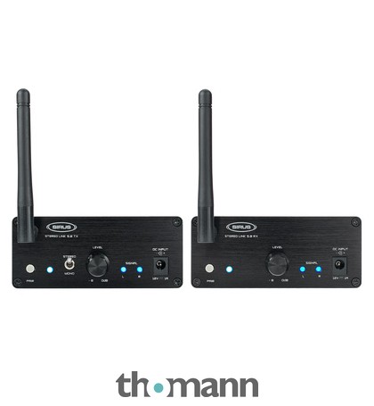

But if you're really set on making life difficult for yourself youl probably need to look to the Pro audio market rather than Hifi.
For example.
