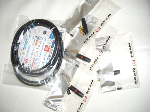

Some of the stuff arrived today......
REAN is a division of Neutrik and even though they are cheap they are well made with gold plated plugs and solid plastic housing.
Here is my first mistake. I could not fit the cable through the strain relief, so I cut it off............
But when I stripped the wire, I found each part has the signal and ground inside it..........
So two more phonos are on order and sadly I have run out time to do anymore as we are away on holiday.....

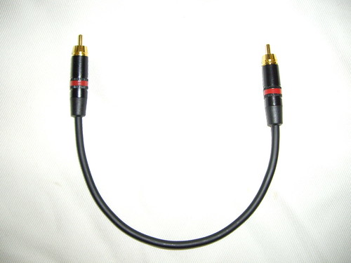

First, measure and strip the minimum amount of sheething of the cable. The smaller wire with its own sheething is the signal wire and it goes into the middle of the phono. The wire wrapped around the signal wire is the earth and it is twisted and goes to the ground which is the casing of the phono.......
Since the phono has no holes the way to connect it to the wire is to tin the wire and tin the phono getting solder onto both........
The connection is made by placing the wires and heating the solder through the case till it melts and joins. Then I have my first IC, the OOTW Solar Mk1.............

The OOTW Solar MkI in action. In comparison to the SHB Synergy 2i that it replaces the olny difference so far is a slight drop in bass depth, maybe, but I will be doing a lot more listening before a full review. Anyway, it works! Something I have made works!
