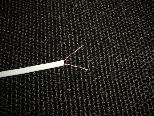

Firstly, tinning. This is the simplest solder and it is used to help keep the strands of wire together and for making connections. Once stripped the wire looks like this......
I dont have a grip yet so I used pliers. The strands are twisted......
Then the solder is applied by heating the wire and the solder so it flows into the strands...
I would invite comments on my various practice attempts. The iron takes ages to heat the wire. Is that right?
idc:I would invite comments on my various practice attempts. The iron takes ages to heat the wire. Is that right?
Well if you think about, the wire is very conductive, for heat as well as electricity, so the initial heat energy you put into the wire is going to be conducted away down the cable. If you snipped the exposed bit off and just tried heating that you'd find it would heat up a lot quicker. It just wouldn't be much use with your speakers though...
Going by You Tube tutorials, you should heat the wire and then the solder will also heat till it melts. They all say dont heat the solder and then put it onto the wire. But I find heating the solder and then running it up the wire is easy and gets the best coverage.

From what I remember it a lot harder to control the flow of the solder if you do it that way, it's probably ok for cables like that but when you come to solder components to a circuit board heating the solder first makes it a nightmare. "It looks like you've dripped the solder from a plastic bag with holes in it!" as one of my old college tutors once complained...
So there is nothing wrong with doing it that way if you find it easier? I have lots of wire to practice with.

So there is nothing wrong with doing it that way if you find it easier? I have lots of wire to practice with. Yes.You will end up with dry joints using that technique. You should always heat the work then apply the solder!

idc:Going by You Tube tutorials, you should heat the wire and then the solder will also heat till it melts. They all say dont heat the solder and then put it onto the wire. But I find heating the solder and then running it up the wire is easy and gets the best coverage.
If you heat the solder up, you risk evaporating all the flux; assuming you are using flux-cored solder. (Which is probably the case.) With no flux, the joints you produce may not have been cleaned properly, and the joint won't be "wetted" correctly, so the solder won't flow. As daveh75 said, you risk dry joints if you do this.
As for keeping your "tip" clean. You should wipe clean your tip regularly, to stop old solder building up and to reduce the chance of dry joints. However, to extend the life of your soldering iron tip, it is worth keeping a small amount of solder on the tip as this does stop the tip corroding. Now I know these are conflicting instructions, but what it means is wipe the tip and then let a small amount of solder melt onto the tip... You don't have to do this.
It's important to leave the soldering iron on the work for the minimum time possible, otherwise you're going to melt insultaion or unecessarily over heat other components. To this end, put a small dab of solder on the tip - and I mean small - before you apply the tip to the work, this will aid in transferring heat more quickly. Trial and error idc, just keep practicing.

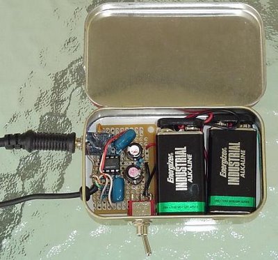

Tangent provides some useful tips for beginners. I recommend that you take a gander at his site. He also provides details on how to build a CMoy.
