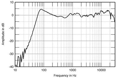

Missions go down to 50hz, the spec say proac goes down to 38hz (+/- 3db)
Here is the frequency responce of the proace measured by sterophile http://www.stereophile.com/content/proac-response-one-sc-loudspeaker-measurements#UWMiz92ZIlZqh3yv.97
If you want to keep the ProAcs, I'd say you're probably going to have to look at a sub to bring out those lower notes. Nothing crazy, just something like an SVS SB1000 should do the trick. Use it subtlely and it'll blend well and give you back what you're missing, and probably a little bit more too.
