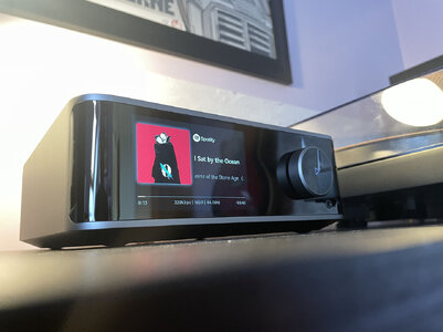

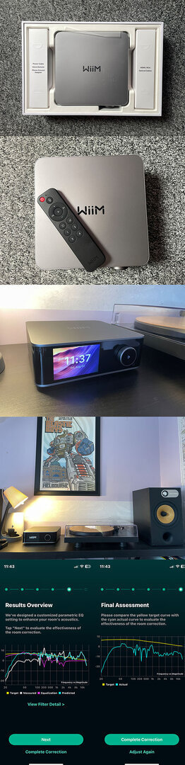

My Ultra arrived yesterday at my local Sevenoaks Audio & Vision store and I picked it up this morning. Connected directly to my Rotel RA-04 via AUX and RCA connected my Pro-Ject Debut Carbon Evo via the phono input, and my even more ageing Rotel RCD-856 CD player via Line In. This is all after I removed the Macbook Pro-into-SMSL SU1 DAC I was using to stream music.
Setup took around 10 mins including wifi connection and software update, room correction routine using my phone and the remote and Alexa/Spotify Connect integration. The unit has an unexpectedly nice weight to it and the fit and finish seems up there.
Know its not the most logical setup with it plugged into an integrated amp, but it works for now and my initial thoughts are I'm liking the sound. Streaming from Spotify sounds as good as the laptop-into-SMSL but I'll be experimenting over the next few weeks but introducing the DAC back into it all as comparison. No huge lag to speak of when it comes to screen responsiveness and track selection (it is there though), and for the money, I'm liking the touchscreen and flexibility. I'm also using Dance as the EQ preset which for me and the music I listen to, seems to add just enough body. Not tried Bluetooth yet but am sure its going to be as expected.
The phono stage sounds like its doing a good job with Beck's Hyperspace sounding pretty epic at decent volume.
One thing I cant for the life of me find is the VU meter! I've been through all the menu's but its so far eluded me, so if anybody knows, do let me know.

Nice 👍
Why not logical?
You may end up preferring it that way - and it's how plenty of others will be using it.
I think you're the forum's earliest Ultra adopter.
Enjoy the tests.
Thanks. I think my OCD is struggling with my setups 2 x pre-amps 😆
Am impressed so far with the Ultra. Lots to dig into on audio options too.
