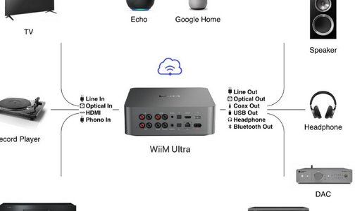

Got myself a Wiim Ultra over the weekend and am wondering about the DAC situation.
As I understand it, dependent on which output you use, it uses either the internal DAC or the external one/the one in the amp.
Is this correct and if so, which is best? The amp's DAC or the Wiim's DAC?

The Ultra has a higher end chip, so you'll probably want to use that as your first DAC option. In this case you send its RCA out to your amp.
I would do an A/B comparison with a digital out from the WiiM to the amp, then decide which sounds best and keep the setup you prefer. When you use the digital out, turn the amp volume down and set WiiM output volume to fixed for best signal.

I tried the SMSL (USB from the Wiim Ultra to the SMSL and then optical to the amp) and I honestly found that the RCA out direct to tha amp sounded better.
That's why comparisons are good. You can stick with what sounds best, or vary input/output combinations as you like. However, i'm not sure you tried the optimal signal path.
To use the SMSL you use a digital output from the Ultra - which you did. Personally, i would have chosen spdif over usb, because i'm not sure if the usb output is equal to the others. (It might be, i honestly don't know. It's listed as 24/192 but there may be more to it.)
Also worth double-checking: did you send a full output signal into your SMSL? The Ultra should be set to Fixed Volume Output (device settings in the app). If there is any digital volume control or EQ applied before the signal enters your DAC, your test is theoretically inaccurate.
None of this might matter to your ears, but i thought i'd point it out. I've been down this path too ... 🙂

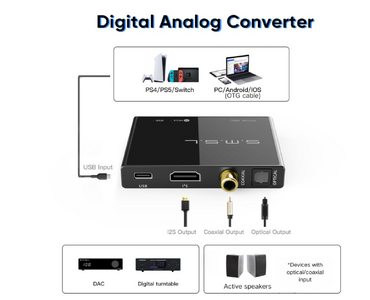

I've just noticed that the only Intput on the SMSL is the USB and the other connections (Coaxial, HDMI and Optical) are all Outputs.
Apologies in advance, I suspect I'm having a dense moment 😏 but why can't you use your spdif or USB output on the Ultra to connect directly to external DAC?
Why the need for SMSL converter?
Having the SMSL middleman isn't going to improve the sound.

I'm lead to believe that the SMSL has a better clocking circuit than the Ultra.
