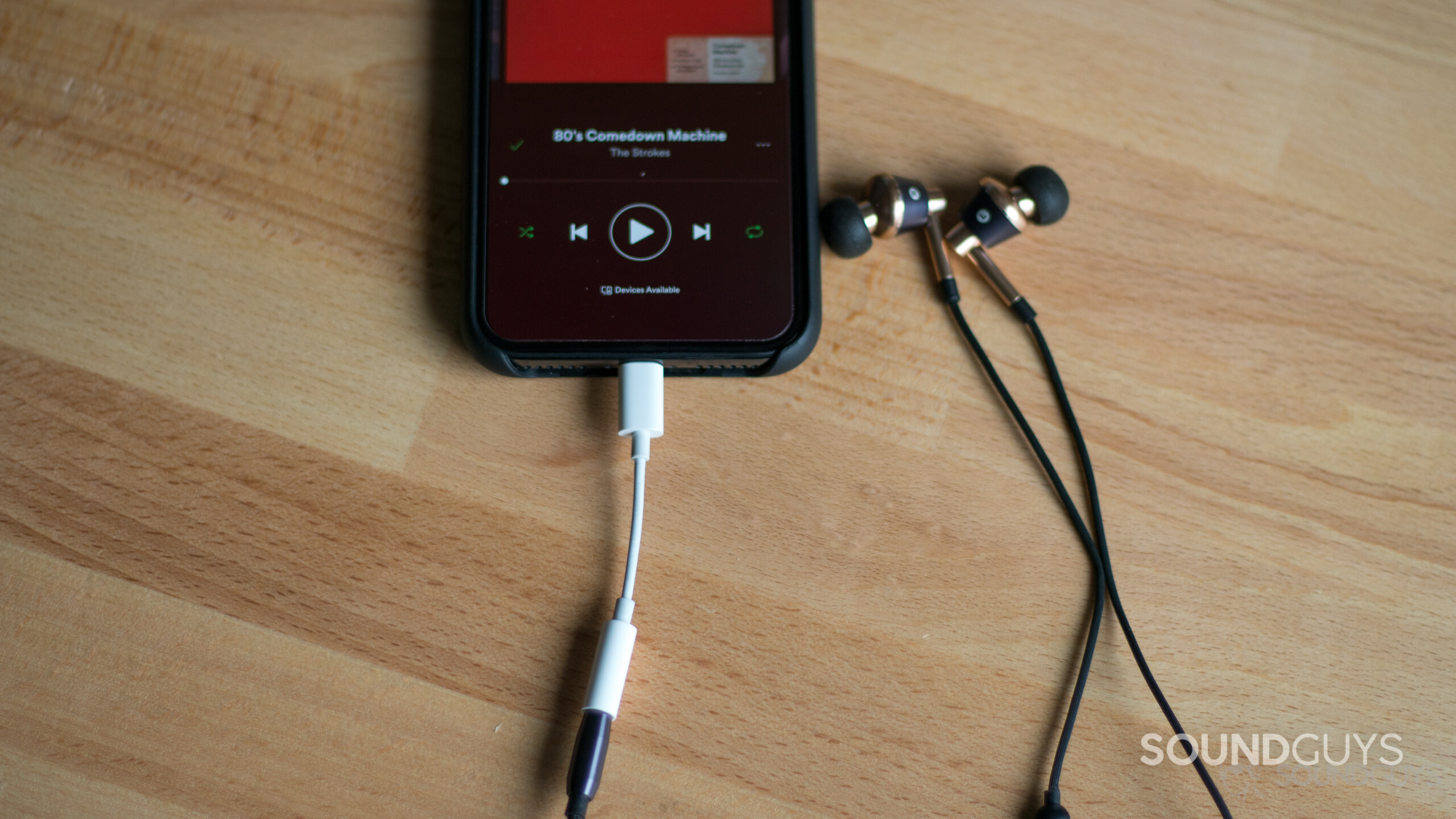

This quote from Soundguys:
"Can you get analog audio over USB?
USB Type-C audio connections don’t actually have to be digital: you can actually get analog audio out, too. The USB standard also supports “Audio Accessory Mode”, whereby the D+/D- pins switch roles to support analog audio signals — again, this isn’t new to USB Type-C. Many phones with and without the new connector are designed to handle the negative voltage swing of the analog audio signal. Accessory Mode is popular with older USB audio dock devices, and the Android Open Accessory Protocol 2.0 with audio support has been around since Android 4.1."

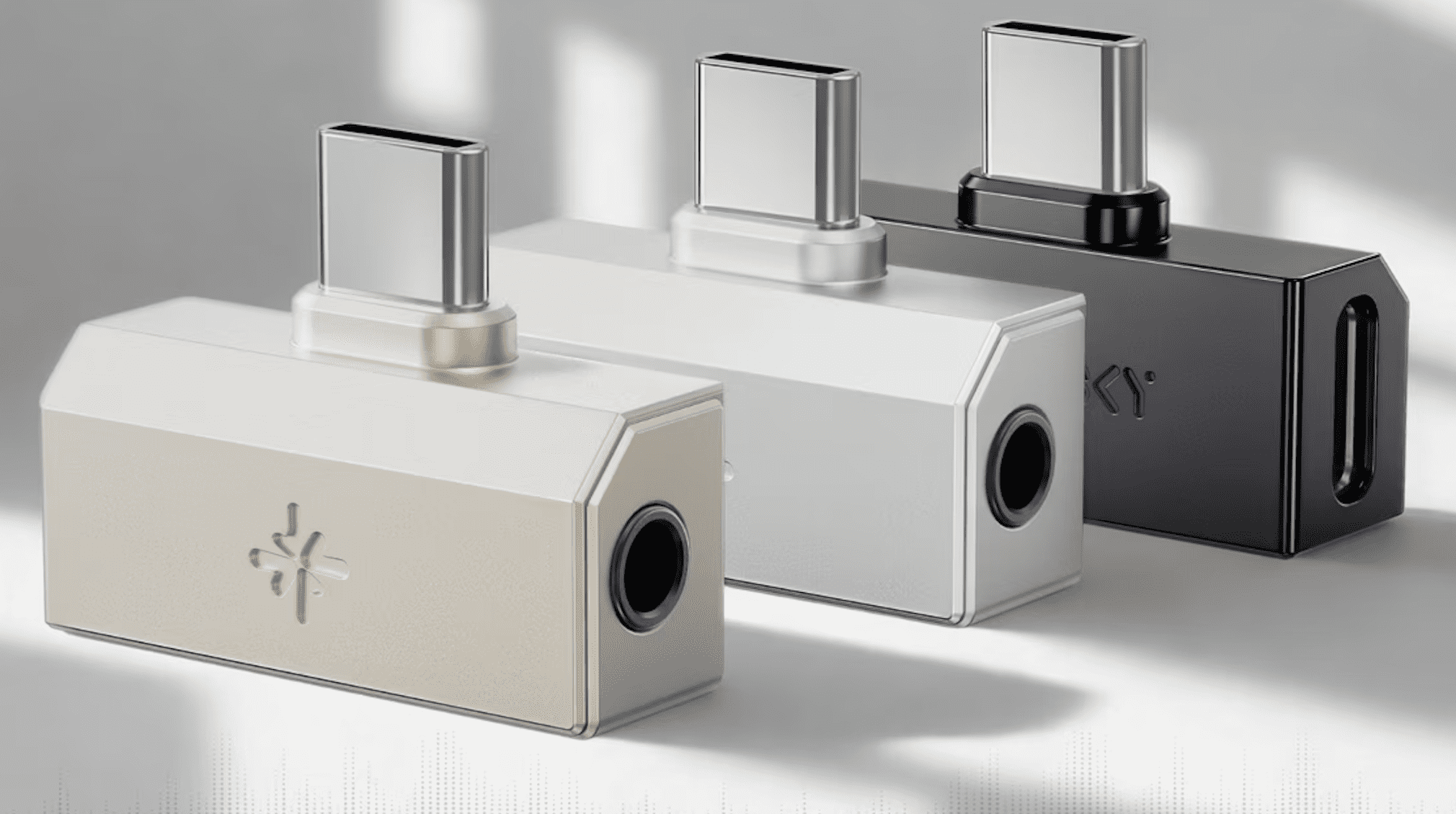

Then what do the 3.5mm to USB-C adapters do?
If you look at (NOT a recommendation!!) from Amazon, you will see for the princely sum of £3.99 you get 2 usb-c to 3.5mm adapters.
Quoting a bit of the blurb...
  • Hi-Fi Sound Performance: The USB C headphones adaptor to 3.5mm jack is equipped with an integrated DAC chip, supporting audio up to 96kHz / 24bit. It seamlessly converts digital audio signals into analog form without compression, capturing every nuance and detail. Experience the pristine sound quality of your music, free from noise.
How good a DAC chip which costs pennies is, I leave up to find out.
I have something similar bought several years ago, as an experiment. I'd describe it as "seviceable". My Ifi is definitely a step up.
