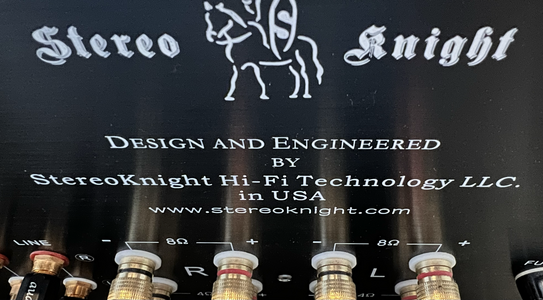

Happy owner of a StereoKnight Lancelot S40. It’s a magnificent amp to me 😊
But I can’t find any information about it. I’ve searched the web (a lot), but all I’ve found is a thread at audiogon.com.
I would love to know some more specifications
Anyone who can help?

Thanks for all responses 😊
I managed at last to find some info.
So I will share it. This info was from stereoknight.com
