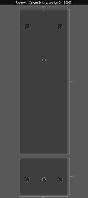

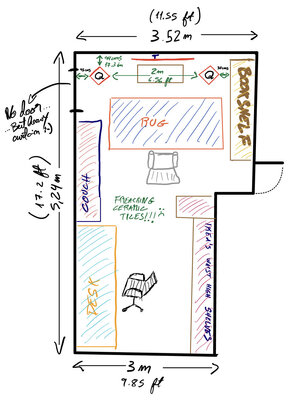

I'll try to post a not up to date drawing of my room
That listening chair is no longer there and the couch went 90º and in front of the speakers. The rug was replaced with a much bigger shaggy 3x2 meters one and the speakers sit on top of it. And the speakers there were the Q Acoustic towers. Ceiling is short of 3 meters tall.
It's a pretty tough room to work with because of the asymmetries. That door on the left and the bookshelf on the right make it impossible to have a symmetrical positioning of the speakers. On the opposite wall I have a big sliding glass wall to a balcony, so that one is not usable.
The better option would have been to use the long wall on the left. That's certainly something I've been thinking about. That and replacing the fake leather pealing 3 seat couch with a fabric 2 seater lower to the ground. But I'll probably have to move by the end of this year, so I don't want to spend too much money on a rented flat trying to improve things.

Hm. That’s a room with limitations, yes. But if you don’t mind refurnishing, you could try moving the stereo setup to the opposite wall. You will get a little less space, and perhaps achieve some more intimacy in your music. Not sure about this, but you could by that also eliminate most of the asymmetries. Especially that corner where the door is. But before you do that, you could also try moving your speakers closer to each other, and adjusting the toe in accordingly. Just to see if it makes any difference.
Working with the room and placement is the hardest part, but absolutely pays of when you get it right.
Also I would bring the speakers further away from the front wall. Too close can kill a lot of soundstage. Try them at 60cm, and decrease the distance between them a bit also. The room acoustics will have less impact on smaller triangle.

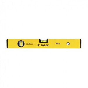

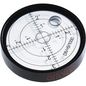

I need to get one of these...
I have something like this, works fine... :sweatsmile:
