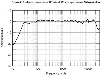

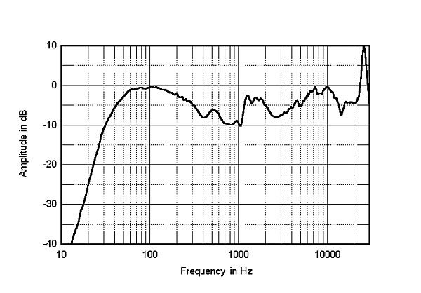

Those two graphs don't look comparable to me. The Dynaudio one actually says it's averaged, which handily makes it look smoother, and it also looks like a faster writing speed, having a similar effect.
The second looks more honest and is probably bang on axis. The 18khz peak suggests it might be a metal dome tweeter, and reminds me a bit of the old Celestion SL series, though I think the treble range was less prominent. The 1khz dip will give a false depth and may sound very pleasant, a bit like a BBC monitor.

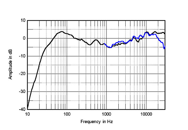

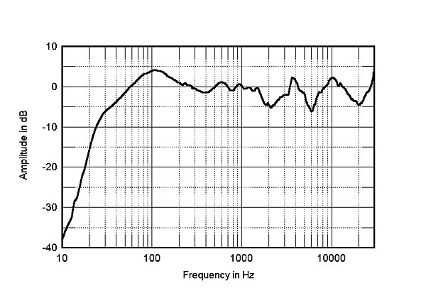

I have just seen some measurements (stereophile) where even expensive speaker don't measure well and wondered if a speaker will sound better just because it has a flat frequency response
B&W 683 s2
Dali Rubicon 8
The last measurements with the dynbaudios is the Paradigm Prestige 95F
Another one with a flat frequency response Kef Blade Two
