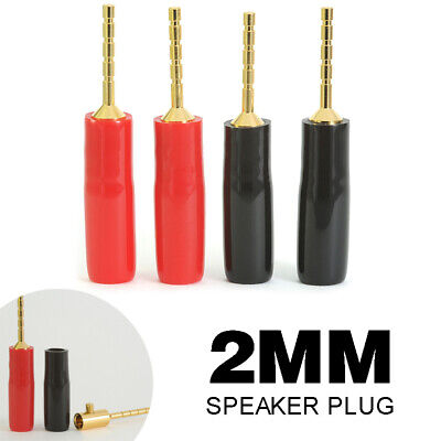

I'm trying to find out if any of the spade cable connectors work with the now older style amplifier terminals as per the picture.
Where my stereo is it's a complete pain to access / get the bare wires into the terminals and would have thought if there is such a thing itds make it a whole lot easier and something that converted the old terminals to female banana plugs would be even better still.
I'd attached a pic below of the type of terminal I mean.

I haven’t seen them often, but I recall it’s possible to choose ‘pins’ as a speaker cable termination. They should fit your old sockets, as does stripped wire.
I guess you need a short length of ‘bare wire to banana socket’ x 2 to sort it out.

Something like these should do it: https://www.ebay.co.uk/itm/233973505046?
Similar designs are available.
eBay or Amazon have them in stock.
Ahhh ... OK ... I've seen those before but never looked at them in detail, I've "assumed" (Rule 1 - Never assume) when it says banana plug they were the standard 4mm type but looking at them in more detail it seems they're much "thinner" and would fit in.
Do you happen to know if the end can be "shaped" .... i.e. bent a bit more or not, either way they look like a good option so thank you!

I think they are instead of a bare wire connection so yes are thinner than std banana plugs. As for how pliable they are, not sure, maybe get 8 and try bending some :)
I was going to grab a set of 8 as I have a 2nd amp they'd be useful for if they work well and again is awkward to get to.

Yes you're right .... I've ordered some of what WayneKerr (is that your actual name?) suggested above and should be here in the next couple of days.
I also found these in researching following his suggestion
I may find a 4 pack of those from somewhere as well and see which is easiest to fit.

Those ones are unnecessarily expensive.
These are the ones I bought (to use instead of bare wires into springclip terminals on a little class D amp):
I needed to shorten mine.
They might bend sufficiently for you - as a quarter / half- circle (rather than full loop) might be all your terminals will accept from their single entry points.
....although those ones in your link do seem to have much more bendable wire 'pins'.

I could be wrong but the two item links you have provided could be just as problematic as a bare speaker cable connection, methinks you need something solid. Let us know how you get on (y)
