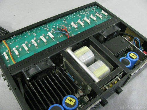

In Germany, using professionnal power amps for Hifi is actually a normal thing. They are groups under different forums, that are speaking about their lovely monsters.
I must insert me in the discussions above. But you could have pro amps made with valuable components, but you can have hifi amps made with not so amazing components too. Quality component is mandatory of the status.
The bottom picture looks a little like my amp also
