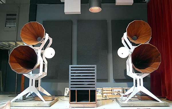

what about these? :) although they would fit a normal barn but don't look too baroque. maybe rustic.
They look like a relic from "It's a knockout" - designed to launch wet sponges at hapless contestants.
