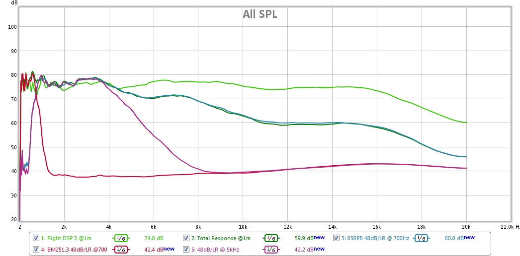

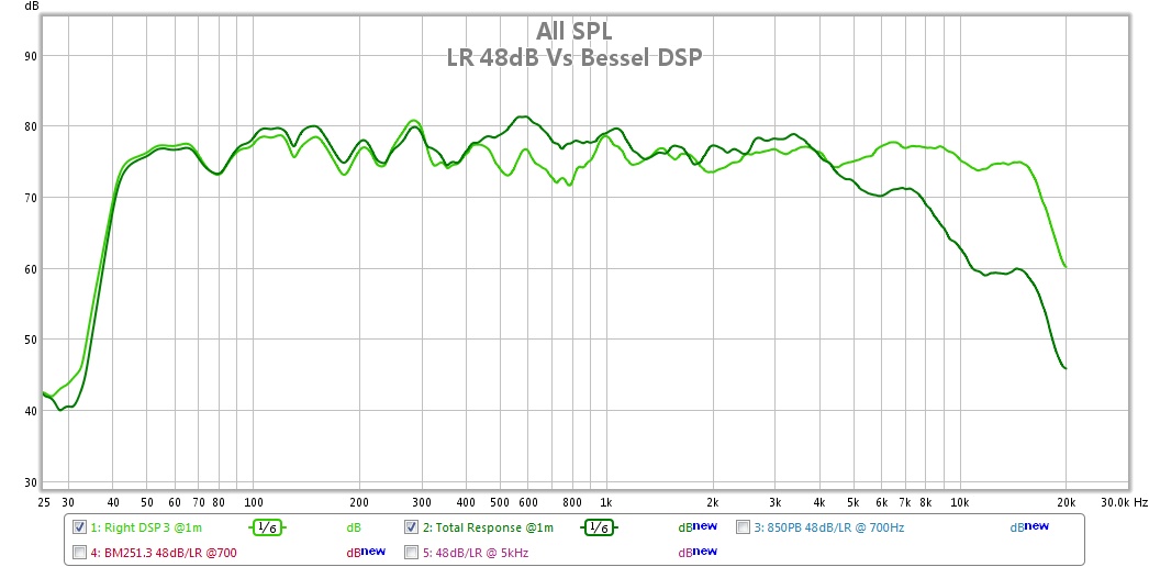

An example, comparing DSP to minimal filters:
The DSP one sounds terrible, even with the roll off it sounds a lot better.
