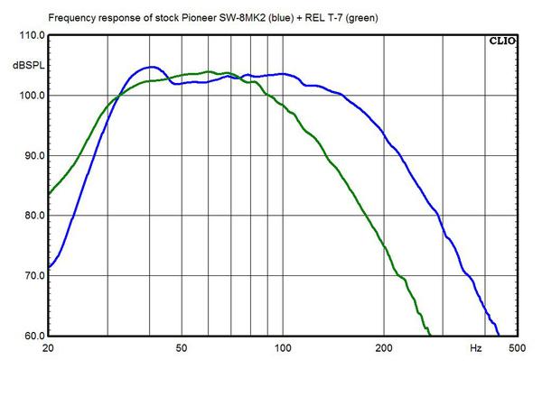

SVS does acoustic suspension. I'd have one of those if shopping for terror.
If getting the very best Sub for a spend of 800 GBP, is what matters....I would be looking at the SVS SB2000
This is really nice. SVS SB13-Ultra
Probably the best Sub in its catagory....but like all Subs from the US, has got very expensive.
An impressive flat FR curve. This would be great for music.
REL T-7 (green line) not as good.
