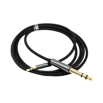

If you wanted to use those two items, you'd need something like this to go between them:
