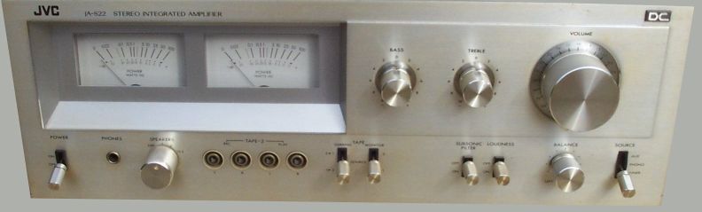

Back in the late 70's I did a disco in a small hall with my JVC JAS22 amp ( 40w per channel RMS ) with a largish pair of speakers. This amp had power meters on the front and the *average* (not peak) power output was about 25w rms. Comfortably within the reach of this amp.
Absolutly wonderful amp with an awful volume control! Fancy JVC wrecking it with a vertical slider!

Hughes123:Tony_R:
No sliders on this one Hughes, this had a conventional rotary control.

Tony_R:Hughes123:Tony_R:
P.S. Hughes, if you ever want to sell that A-X5 of yours.... <please!>
Tony.
Wow! That's nice! I could have sworn that had the SEA controls and the slider volume control, but it must have been the 44 model...how much would you pay for the A-X5?

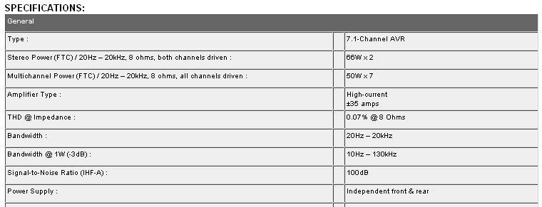

thanks for the comments.
Ok, I get the 'damping' thing, but I don't know how it's measured. I've had a look at the specs. Is 'THD' the damping?
If so, it's rating is: THD@impedance: 0.07% @ 8 ohms.ÿ
Could one of you knowledgable folk tell me if this is a good rating?
Many thanksÿ
THD stands for Total Harmonic Distortion - it's basically the amount of distortion an amplifier produces at its output stages and is normally quoted at near full power of the amplifier into a common load (ie. impedence) such as 8ohms. It is also normally quoted at 1khz or from 20hz-20khz. This is not a true measure of the distortion of an amplifier however, especially because of the 3rd and 4th order harmonics which play a big part in the "richness" of the amplifier.
bretty:
Many thanks
No - THD is "total harmonic distortion".
There should be a rating called "damping factor" which is just a number - it has no 'label' as such...
And THD should usually be given at various power outputs. 0.07% is a fairly typical figure, the best amps can achieve 0.0001% in some case - again this will be measured at different frequencies and power outputs.
Typically at the very least, the distortion will be rated at 1khz ( 1000 hertz ) into 8 ohms.

Hughes123:
Hughes, you are indeed correct about the JA-S44 - that did have a slider.

Just been checking the specs myself, and no damping factor mentioned.
However, a High current power supply and independent supplies front and rear are mentioned.
Plus, the power drop with all 7 channels driven is not bad - which does seem to confirm their claims of a high current (or to use the lingo - 'stiff') power supply. This thread has gotten so long now - I can't even remember why you were asking the question in the first place! But if the title is anything to go by - assuming you have a reasonable sized room, and not horribly inefficient speakers - this is more than adequate...
I also note they quote the power specs to the FTC standard.
"The FTC standard, established by the Federal Trade Commission, requires a manufacturer's stated power rating must be met, with both channels driven, over the advertised frequency range - usually 20 Hz to 20 kHz - at no more than the rated total harmonic distortion (or THD)
The FTC rating gives you the average power output for both channels over a wide frequency range and lower distortion level. This is a much more conservative - and realistic - measure of an amplifier's average output power."
Quoted from this site: http://www.soundandsong.com/Issue004/004_PowerAmpRatings.html
