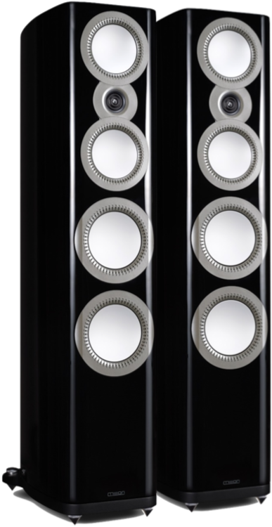

I've been looking at these Mission Zx 5's but it states they are Home Cinema speakers? 🤔
As I've been happy with the warm sounding Mission 733's I've been using over the last few years I'm thinking of staying with Mission, but to upgrade to a better quality speaker, these would be a definite upgrade on the Mission 733's?
Hi,
I would ignore the Home Cinema attribute. The Mission web site states nothing about them being home cinema design or usage. In the end, listen to them, and if they are the best sounding for you, then buy them.

I see the above Missions recommend an Amp of between 30-200 Watts.
My Marantz PM50 has 70 Watts (from what I've found on line as its a 32 year old amp!!).
Therefore my Amp should be OK to run that?
However I also looked at the Monitor Audio Silver 500 and they recommend an amp of 80 Watts - 250 Watts.....
And then I read that the Amp should be twice the power of the speakers max Watts to avois clipping......
That would mean I need an Amp of 400 Watts and even a 2.3k Rotel RA-1592MKII is only 340 Watts into 4 ohms....???
I believe My PM50 is 70 Watts into 8ohms?? does that mean I'm limited to those Missions above otherwise I risk blowing the speakers/clipping?
The room is L shaped with the bottom of the L being Approx 16 ft x 14 ft but then the tail of the L being around 100ft long.....

Hi,
The Missions lowest impedance is 3.4ohms, they are rated at 4ohms, and have a sensitivity of 91dB. So for normal domestic listening levels the Marantz PM50 should be acceptable. If you start to listen at high sound levels, then you will need an amplifier with a sufficient power supply for a 4ohm load.
Without the impedance curve for the ZX-5's, then it is difficult to determine with any accuracy if the 3.4ohms minimum is a sharp dip at the high frequency or low frequency, and wider dip at which ?? frequency.
For the Monitor Audio Silver 500 they are 90dB, 8ohms yet their minimum impedance is 3.1 ohms at 2.45kHz. This extra information means that since there is minimal sound energy at 2.45kHz, that the dip to 3.1ohms is not an issue. Yet the state an 80watts amplifier minimum. This is odd. So i would ask someone who owns them or a dealer if a 70watt amplifier is sufficient, as the numbers show that 70watts should be sufficient for normal domestic listening levels.

Hi Shadders thank you for the above detailed explanation, I'm a real newbie to Hifi therefore I don't have a clue about what's compatible with what.
Therefore both the Mission and the MA should be fine running from my Amp under normal listening levels?
And if I wanted to turn them up really loud I would need to purchase another Amplifier?

Hi,
For the ZX-5 with 91dB sensitivity, then for 70watts will produce 109dB SPL. The issue may be that the current required due to the 4ohm rating may mean that the amplifier has insufficient capability to sustain this power requirement. Without the impedance curve, no definitive judgement can be made.
Yet, if you are listening at 100dB SPL this is a disco at 1metre :
The 100dB will require 8watts from the amplifier. At this power level requirement, the 4ohm rating should not be a problem.
Similar for the Monitor Audio's, yet they are rated at 8ohms, (90dB/W), which will require 10watts for 100dB SPL. The current requirement if they truly are 8ohms is less, although they have a 3.1ohm dip at 2.45kHz. The 80watts minimum is an odd figure specified.
I would expect that the amplifier is OK to drive the speakers.
