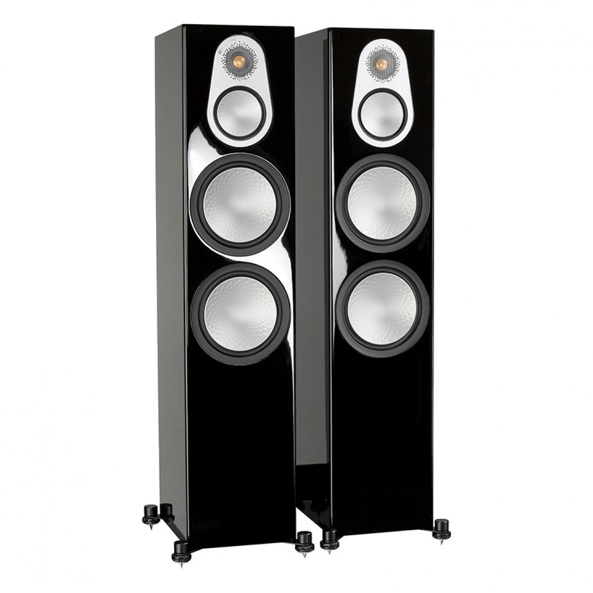

However I also looked at the Monitor Audio Silver 500 and they recommend an amp of 80 Watts - 250 Watts.....
Hi,
The Missions lowest impedance is 3.4ohms, they are rated at 4ohms, and have a sensitivity of 91dB. So for normal domestic listening levels the Marantz PM50 should be acceptable. If you start to listen at high sound levels, then you will need an amplifier with a sufficient power supply for a 4ohm load.
Without the impedance curve for the ZX-5's, then it is difficult to determine with any accuracy if the 3.4ohms minimum is a sharp dip at the high frequency or low frequency, and wider dip at which ?? frequency.
For the Monitor Audio Silver 500 they are 90dB, 8ohms yet their minimum impedance is 3.1 ohms at 2.45kHz. This extra information means that since there is minimal sound energy at 2.45kHz, that the dip to 3.1ohms is not an issue. Yet the state an 80watts amplifier minimum. This is odd. So i would ask someone who owns them or a dealer if a 70watt amplifier is sufficient, as the numbers show that 70watts should be sufficient for normal domestic listening levels.

Similar for the Monitor Audio's, yet they are rated at 8ohms, (90dB/W), which will require 10watts for 100dB SPL. The current requirement if they truly are 8ohms is less, although they have a 3.1ohm dip at 2.45kHz. The 80watts minimum is an odd figure specified.
I would expect that the amplifier is OK to drive the speakers.

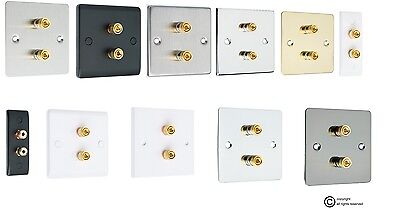

If you are installing the speaker wire directly into your walls, make sure you have left enough spare wire at the point they exit the wall to bring the speakers into the room, so they are not near the walls. They sound much better further away from the edge.
Also, be aware that different speakers have the terminals at different heights - some are at the top and some at the bottom. I don't know where yours are currently.
You should allow a good bit extra at the point it comes out of wall to move the speaker and to also future proof for you changing your speakers if that's the intention.

An option would be to fit wallplates, then future wall-to- speaker leads could be any length you need. (Though purists would want to avoid the extra plug / terminals involved and keep continuous wire).

In a previous house, i installed plates are the hifi end and ran biwire (QED79 and twin core + earth) to plates where the home cinema speakers were, so i could plug them in and move them once the film was over.
