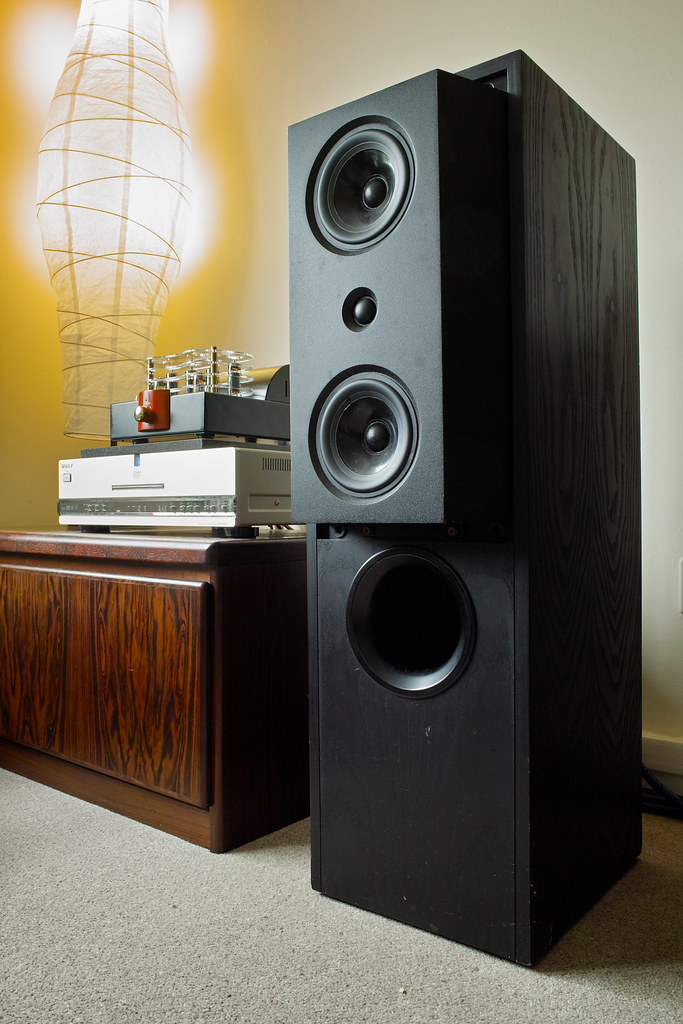

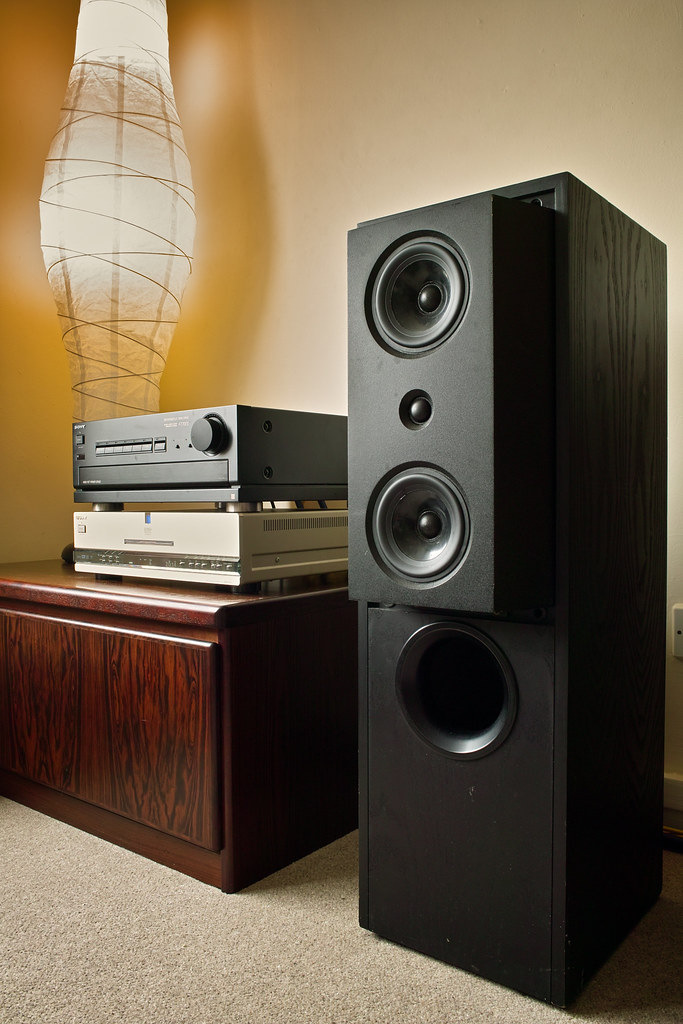

I really liked my 104/2s and if I had had a bigger room, probably would have kept them. The main failing points are the bass drivers, the foam outer surrounds and inner surrounds degrade over time. They will degrade, so if they have never been replaced, then you will need to budget £200 or so to get someone to replace them for you. Its quite an easy if time-consuming job to do it yourself.
The other thing to check is the tweeter, it has a common problem with the ferrofluid, it dries up over time and can reduce the tweeters output level, again this is a relatively easy job to undertake and aparently can 'transform' them if they sound a little rolled off.
I used a Sony TA-F770ES with mine, and thought it was a good match although that was only evident at high volume levels, I used a Puresound A10 (8wpc PP valve amp) before and it was fine. The 104/2s are a 'easy' load for amplifiers, around 95db/1m/2.83v and a constant 4 ohm load makes them perfect for voltage amplifiers with a transformer output, such as any valve amp with a 4 ohm output transformer tap.
I only had problems with bass, some odd booming in my room, that based on more recent experience could have been addressed with bass panels.
The 104/2s themselves, are great, really good mid-treble integration, very good dynamics and very well defined soundstage, I actually prefer them to the more modern Reference models I have heard (203/2 and 205/2). They do work well near rear walls but they need a little space.
