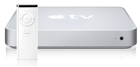

Right...
Firstly, let me just point out again that I'm talking about the older generation apple TV, not the new black one:

The Onkyo does have a built-in digital-to-analogue converter, yes. You can connect the Apple TV to it using a simple optical cable, thus avoiding the Apple TV's own analogue outs. This means that you can bypass the Apple TV's less good analogue output - the reason that some find the 'music from the @TV [on its own] is poor'
If you want to play music through it, however, I would audition other AV receivers as well, since to my mind Onkyo can make a bit of a hash of music in the wrong setup. Yamaha always get my vote in this regard. Note that this is from my experience of several Onkyos, but not the 608, so take that under advisement.
mcchazza:can I connect my external HDD to the @TV?
Only if you install ATVFlash or, if you fancy a bit of Unix command line, there are ways of doing it for free. Google is your friend. You need to do this before you load anything onto it though.
mcchazza:And, when this is done (and this is key) - can I control what I play from the @TV from an iPhone or remote
Yes, though I would warn you that you probably won't be able to see the VOB files at all on the iPhone, only by navigationg using the Apple TV Remote. This could be a dealbreaker in terms of navigation...
mcchazza:i.e. do I need to keep my Mac switched on?
No.
Hope that helps if you decide on the @TV. However, I will say again that if you want to make exact ISO/VOB copies of your DVDs and play them back, then the Popcorn Hour or AC Ryan (or even the little Western Digital WDTV Live) will probably give you a better user experience. And tbh, converting to FLAC is probably not that big a deal with something like dbPoweramp - though admittedly cover art may be a bit of a manual job.

If u are looking to rip dvds ATV = avoid.
Video playback is poor, and format support practically non-existant.

Disagree on your first point, agree on the second, but ATVFlash makes it much more flexible (though by no means perfect).
What would you recommend the OP do, TM?

Thanks again all - I bought the @TV as recommended and am getting round the movie question by getting the Sony BDP-S570 Blu-Ray - currently agonising over the massive choice of 3D TVs...
