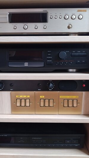

totally agree, i do the same, only the tv box and tv are on, well stand-by every hour of the day, music components that i put on everyday, due to problems with fading displays i turn all off each day before bed, just a on/off switch that i can switch off with my slippers
Reactions: The_Lecht_Rocks
you have stuff you can switch off with your slippers???
Shucks, mine require a finger......
