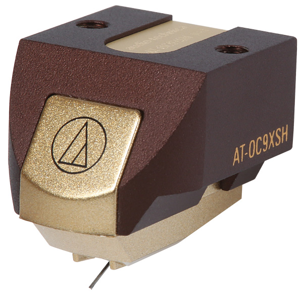

Just remembered this very thorough review in HFN including measurements. It’s of the slightly more expensive AT but the others in the range are described in some detail too.
The AT range is always worth a look. A very broad range.

Just a brief update:
Pulled the trigger on an Audio Technica AT-OC9XSL. Fitted it this afternoon and initial impressions are impressive. The Cambridge Audio Duo seems to handle it ok although the built in headphone amp is a bit weak but coupled to my Little Dot tube headphone amp it is driving the Audeze LCD-2c really well..
