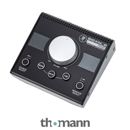

Why active speaker for an amp 99.9% would use with passive speakers
if you want to use active speakers get one of these monitor controllers, you don't even need to buy one with a phonostage and if you only would use a turntable you don't need digital input .
The one i use
phono stage,dac and amplifer+ binding posts is just waste of money when you don't need it with active speakers and a turntable with built in phonostage
The one i use
Thank you.. It looks sensible.. I tried previously with my Yamaha AG03 Mixer + turntable+ Tannoy but didn’t work, my aim was just to have a volume knob in between and I was told to get an amplifier which didn’t make sense to me. I have my Tannoys and I’m satisfied with them. So I’m trying to make use of what I have in hand. I can return the amp as I don’t need it, I’m just trying to understand what I need to make this setup work and why it’s not working 🙂
Depends on what you wanna use, it's not easy at all to adjust the volume on the back of the speakers or having to adjust both speakers to the same volume
Pick what ever you like, i have the cheap mackie big knob passive https://www.thomann.de/dk/studie_monitorcontrollere.html?oa=pra&filter=true&ls=100&gk=STMOMC
If you’re happy with Mackie big knob, that’s enough reference for me 🙂 I’m not looking for something sophisticated. Does the name have anything to do with speakers being passive/ active? Can I still use it with my active monitors?
