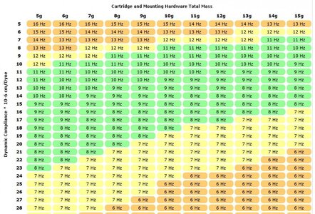

Warped records could be a problem if Tonearm / Cartridge are not Cu matched and the reason many TTs are fitted with record clamps to flatten the warp
Rega is a med mass arm should be used with medium compliance cart
You can group cartridges roughly in three categories:
LOW - 5 to 10 μm/mN
MED 10 to 25 μm/mN
HIGH 30 to 50 μm/mN
Cartridges have a compliance rating Cu
Low Cu stiff suspension , High Cu soft suspension
8-12hz ideal range
under 8 Hz Resonance overlaps with record warps, footfalls, rumble
will cause woofer pumping, mistracking, or skips
Above 12–14 Hz Resonance moves into audible bass region
will cause bass coloration, onenote bass, and reduce tracking ability
