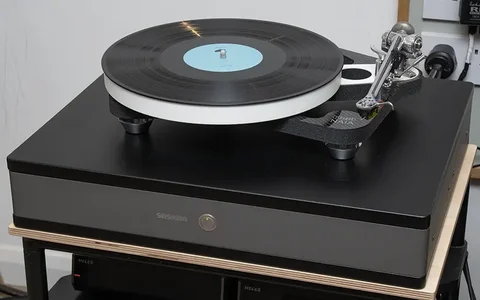

Most TTs just plonk on any surface and they work fine
Rega are hyper critical to support structures they like light and very rigid
Have a Rega Niad with a electron microscope isolation platform
Not Cheap But huge improvement in Sound
