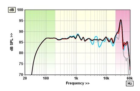

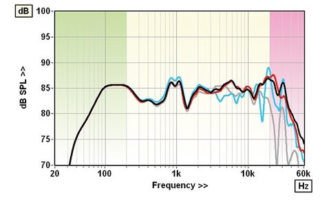

Both speakers are tested here (hifi.news)
guess what speaker is mine -6db 49 and 56hz 88% in sound quality vs 84%

Of course, isoacoustics (3 or 8 inch including angle) + room correction and bass port foam i think comes with the speakers, there is pleanty of adjustments
What surprises me is the bass responce, biggest difference between the 12.1 and 12.1 i is improvements in the bass, bass port and internal damping + mabye the crossover parts, subtle upgrades (why fix it if it aint broken) everything else is the same
F3=61hz rated f6 is at 60hz Mine is f6 at 56hz and midbass is not flat = adjustments
