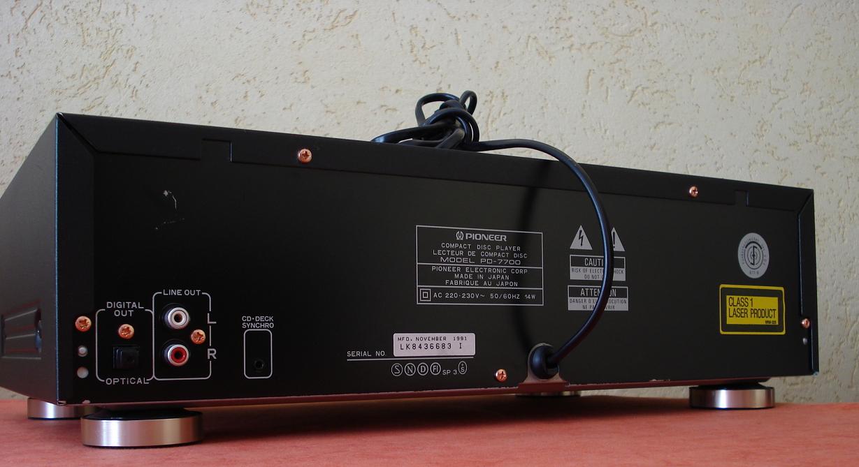

these are the connections on the back:
The CD Player has no digital inputs. You cannot use it as a DAC for your laptop. Using a CDP as a transport means that you would be using it to read the data from a CD and then send the data to an external DAC.
Vlad explained it perfectly above.
