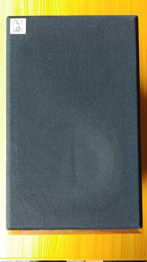

There were these other interesting mini speakers. The brand sounds almost like something made up to get some credibility.
They say a picture is worth a thousand words (even though I've already given you a thousand words 🤨)......

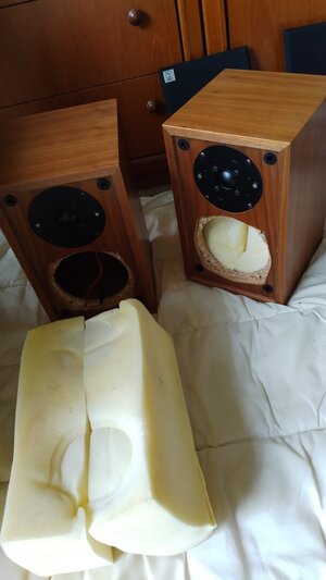

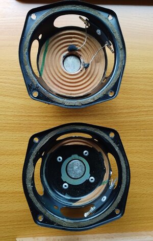

Might just need a couple of mid/bass drivers 🤔
They'd been glued as well as screwed - which must've been the reason someone had abandoned the removal attempt.

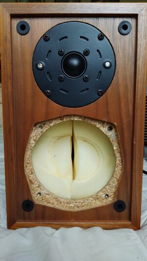

Nice SEAS tweeters - as used by others - and giving some nice HF out.
Plenty of internal foam...

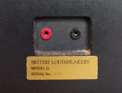

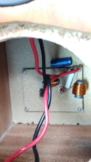

Simple crossover. But simple doesn't mean bad - that 7 microfarad cap is used in some well respected speakers, so I've discovered -and who needs a PCB? 😁
A potentially great little sealed box monitor...the only spanner in the works is the cost of replacement drivers.
Bextrene-coned Kef designer B110 from Falcon cost an arm and two legs, even for a non-matched pair (not critical as my ears are a non-matched pair).
Wilmslow do a paper coned alternative, still expensive.
I've found German made Visaton, £40 the pair at CPC - but they require cabinet modification....might have to get a sharp chisel out.
Even the Falcon and Wilmslow pairs may require cab mod - don't mind modding after spending £40, but would want drivers costing hundreds to fit straight in....
